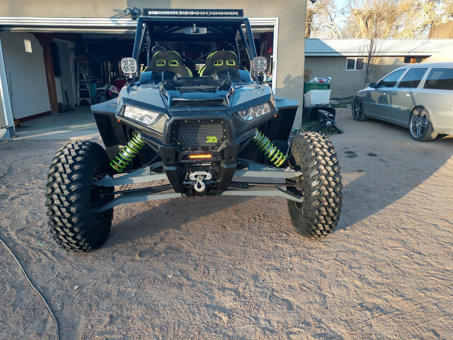

14' XP1K4

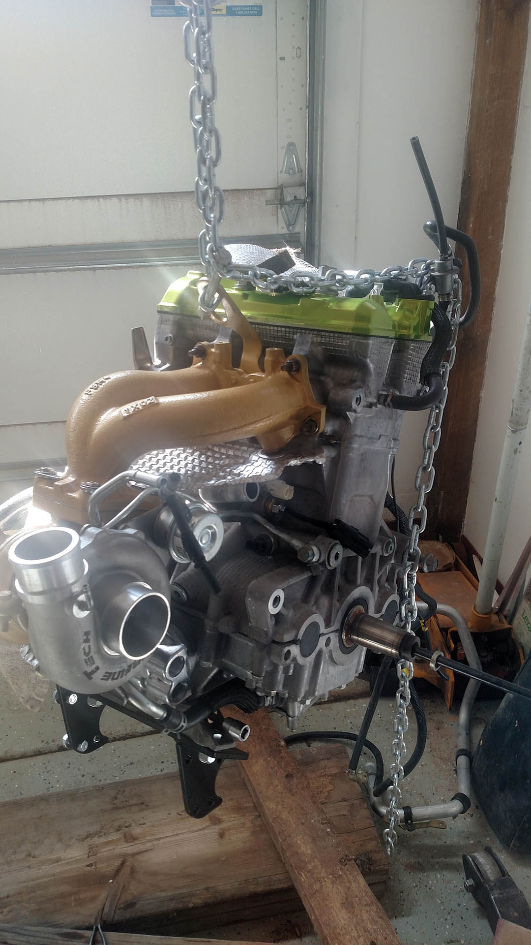

Z1 Air to Air with Devils own methanol 24psi on 91oct ~300HP/~260HP and limping home 200HP
HCR long travel finned IBP kings and what not

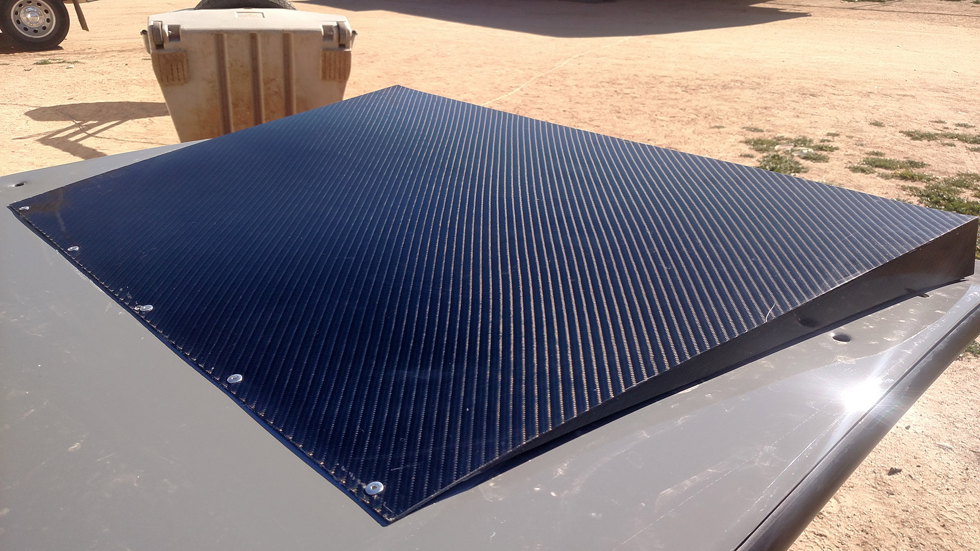

custom carbon lightbar scoop

Method 401s with Tusk Terrabites (32")

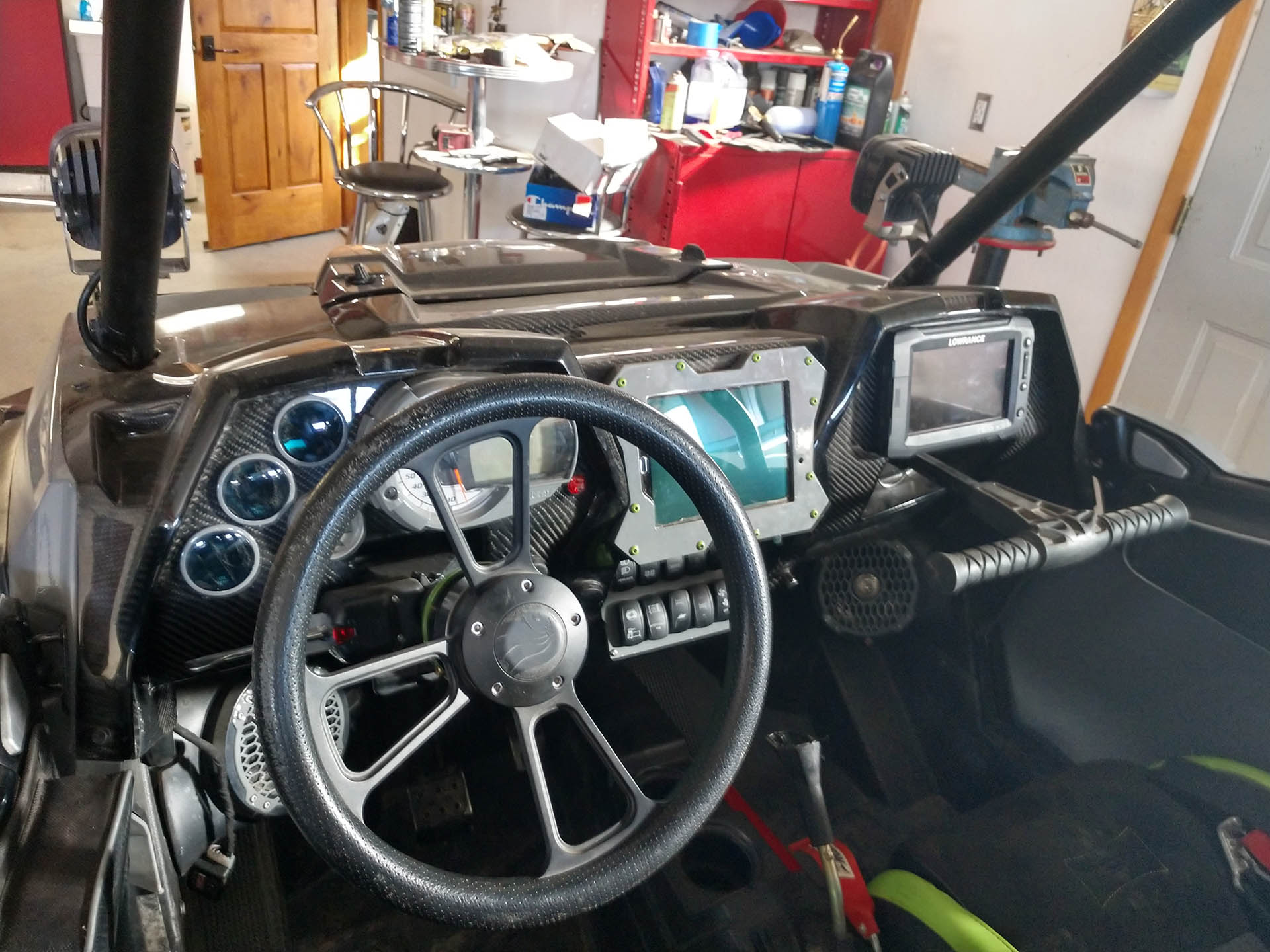

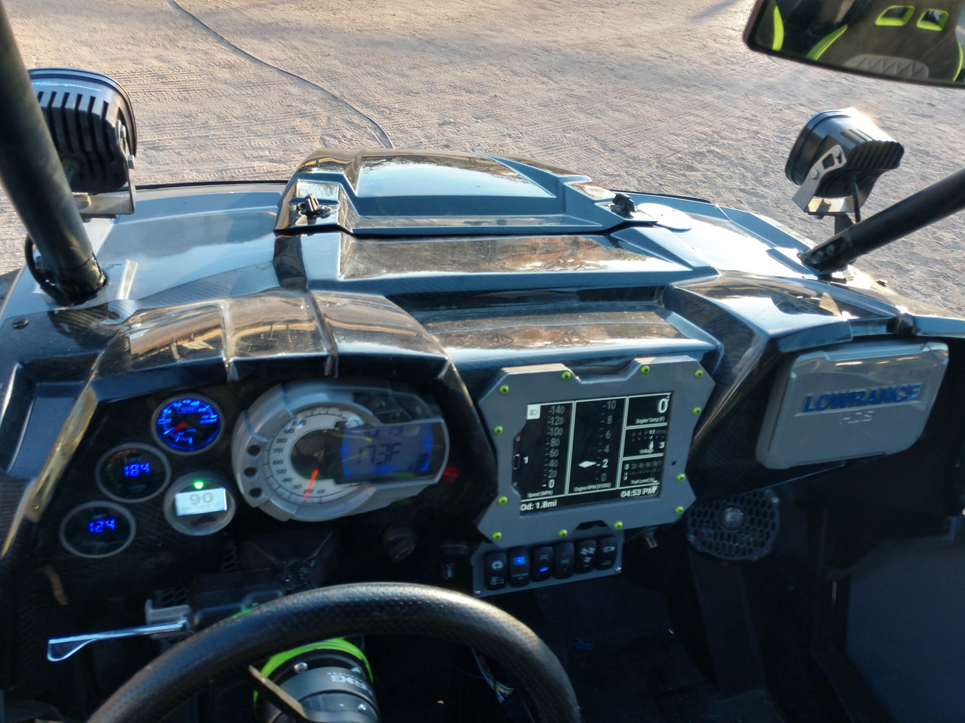

Android tablet in mob armor dash with NextStage ECU interface for displaying AFR, and engine vitals
Lowrance HDS7m Touch

its a z1 swap with a stage II turbine tech turbo and devils own methanol injection. 320hp tune on pump
