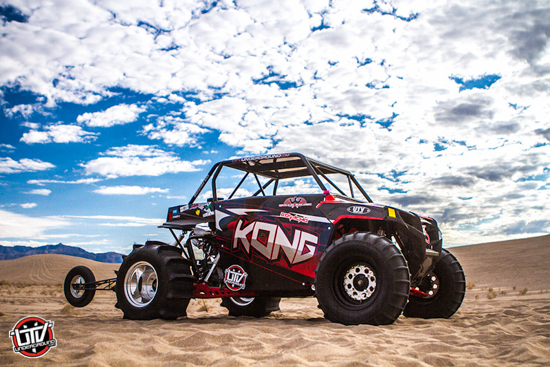

Drag racing is a part of motorsports and it has slowly transitioned into the UTV segment with more and more companies and enthusiasts building their UTVs into sand drag machines. We are entirgued by the vehicles those involved are building and it was a perfect time to get up close and feature one of our favorite drag machines built by long time UTVUnderground.com forum member Bart “GOVACHO” Chielens. Bart with help from Queen Racing and a host of other sponsors has built one of the coolest looking and fastest drag RZRs on the planet! We caught up with him earlier this year at SXS Wars in Dumont to BREAKDOWN this amazing machine he named “KONG”!

Queen Racing Z1 Conversion Kit Specs
• New Arctic cat crate engine
• Cp custom pistons
• Carrillo Rods
• Lightweight and balanced crank
• Custom head gasket
• CNC porting
• Titanium intake valves
• Inkonell exh valves
• Queen racing spec cams
• Queen Racing valve spring kit
• Custom intake manifold
• Wilson Billet throttle body
• Queen racing turbo kit with Garret turbo
• Link/Vipec ecu
• Custom wire harness
• STM oversize custom clutches
• Custom fuel cell
• Bosch 044 fuel pump
• Marvin Shaw shocks
• Custom dual catch can
• 13.00 plus 15 custom paddles
• Weber dry sump tank
• Billet fuel pres regulator
• 4 bosh racing fuel injectors
• Tial Wastegate
• Wheelie bar with Marvin Shaw shock
• Single seat center drive
• Electronic boost control
• AFX Wideband controller
• Fuel Customs air filter
• Custom light weigh chromolly rollcage
• 465hp at 25 psi
