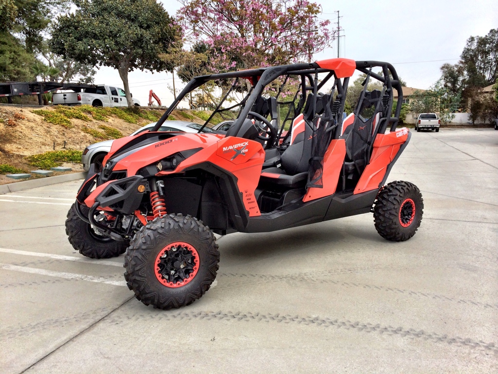

We are starting with a brand new, 0 mile 2014 Maverick Max 1000 XRS with EPS.
The goal is to go back to our roots with a bad ass So-Cal style desert play car!

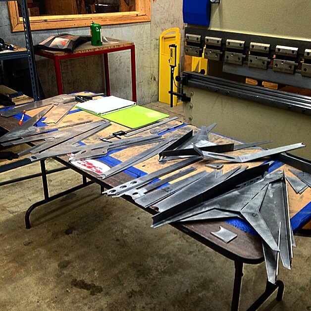

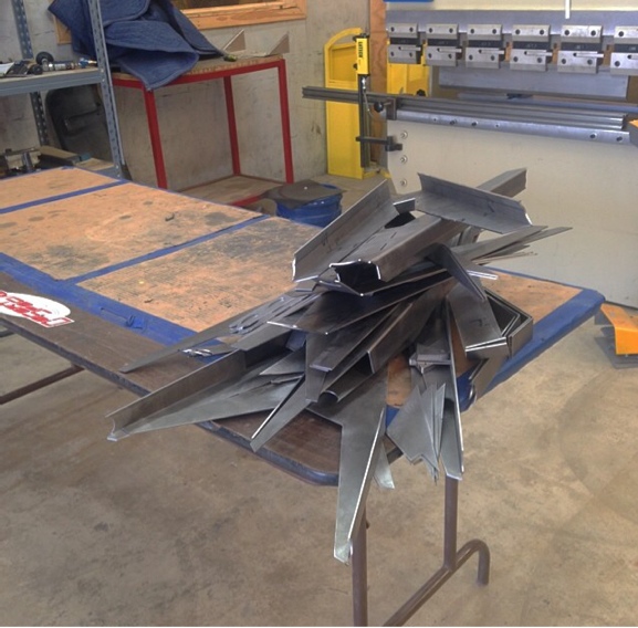

Madigan has already torn the car down and is now starting with his full boxed suspension kit. I will post all the specs soon.
I'll keep posting updates.....

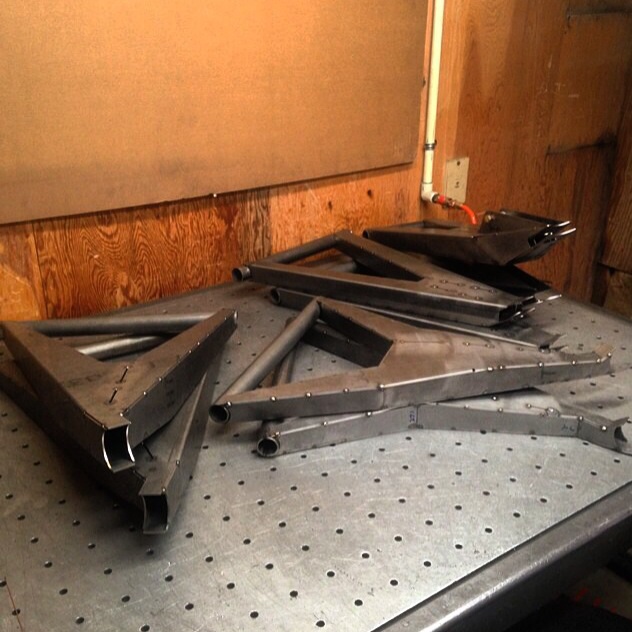

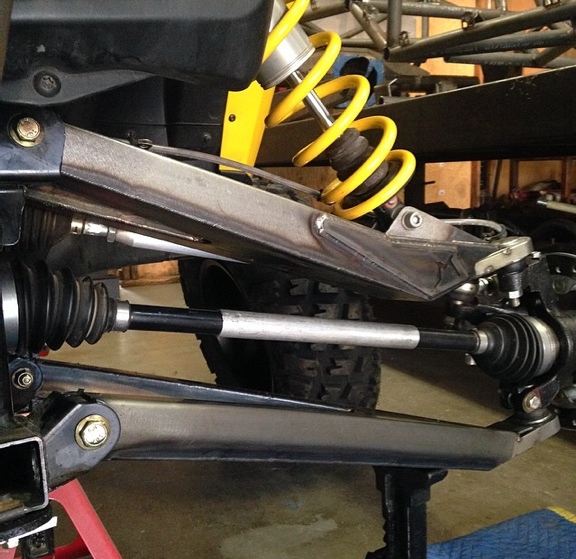

Suspension specs:
+3 per side
4130 Tig welded
Gives you three more inches of wheel travel over stock
Summers Bros axles
Madigan Front Tie rods
Madigan Rear radius rods
Fk rear uniballs
And utilizes stock shock location
We plan to upgrade our factory Fox Podium shocks to new Fox IBP 2.5" shocks once they are ready!
