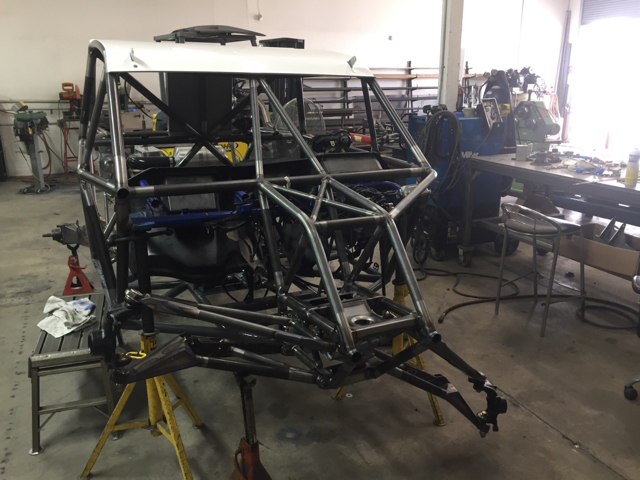

Getting the car to the course is another matter indeed... Few pictures from the weekend. Long way to go and STILL NO SHOCKS....!!!! Ugh...
It looks like it still needs to be wired and plumbed. Do you have the axle/cv/stub axle/hub assy's yet?
In looking at the front lower a arms, it appears that the outside portion of the axle runs in front of the boxed section of the lower arm. Is that correct? It also appears that at ride height, the bottom ball joint position will be trailing the top ball joint position, incurring a negative static caster setting. Am I seeing that right?
I still say if you don't address the mounting plate vulnerability at the end of the rear trailing arms where the wheel bearing plate bolts to the arm, the joint will fail far before its time. Most likely a crack will develop at the heat affected zone of the weld on the bottom/lower section where the bearing receiver plate welds onto the rear face of the trailing arm. Those cracks that develop right at the root of the weld are common place if there is any undercutting of the weld where the parent material and filler rod meet. I assume you used normalized 4130 to fabricate the trailing arm. Is the weldment stress relieved?
Also wondering why the lower rear shock bolt orientation on the trailing arm is not positioned parallel to the pivot axis of the arm to which they are mounted. Although it is a trailing arm, the shocks should be mounted similar to an a-arm layout to avoid binding, and the top shock mount should be plumbed leaning towards the center of the 2 trailing arm pivots.. It just looks like the shock bottom bearing will be close to binding at 22" of wheel travel. There will certainly be a learning curve in regards to the rear the trailing arm conversion.
We have everything except for the shocks and the fuel cell. Kind of important elements. The axle does come ahead a bit on the front, but not a lot. The comment was don't hit rocks. Also it would take a pretty tall rock to get there.
The other items are addressed by the limiting of the front travel. What you are seeing here is past the point of droop.
On the rear yes it is braced and chromoly end to end the welds are double layered and aligned with the arm. I have seen it move, but we don't have the shocks so we cannot do the final mounting for the brackets.
Frustrating to have it this close and not be able to do the final design and Fab until we get the parts. Hope we don't have to redo the rear top mounts. Frustrating but what can you do...
I didn't notice in any of the pics that the upper rear shock mounts were done. Good for you. I'm going to do my best to make it out to the Laughlin event. Its been awhile since I wore my spy glasses, and things are a changin'!
If in the 11th hour you need help wrapping up whatever, let me know. I'm only 2 hours south of you (assuming the car is in Costa Mesa). Will work for Guinness!

A few more pictures from this weekend... I have no idea what this means, but if you have questions, I can ask Will. Will stated that these measurements are from the steering arm that is on plane with the spindle center line.
This shows the castor and bulkhead angles are dead on...

I do not know what the builder is trying to show with the pictures and the digital level. The angle of the top of the steering arm means nothing. It might be canted on purpose to make sure the tie rod has enough movement in a particular direction. If he is trying to show castor, that is not the way to measure it. And castor does not need to correspond to the angle of the bulkhead. What would be more interesting to show is the angle of the upper a arm axis vs. the angle of the lower a arm axis!
Will said someone in the peanut gallery would say that is not how to measure. His response is as follows...
The Castor and Bulkhead angle is spot on. That is what he is showing. Also as for the way he is measuring it. He has the spindle on line with the steering arm so he can measure this way.
Also it is in the computer this way as well. He got the numbers to the specs in the design. Not easy to do with actual metal.
Anyway, will post updates as we go...

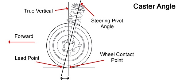

Like motive, I too have no idea what he's trying to show with those two pictures of the level. That ain't caster. Ok back to the peanut gallery.
I understand Ryans confusion regarding the bulkhead angles. I consider a bulkhead to mean the same thing as a firewall. Typically a somewhat vertical plane that separates the driver compartment from the front end of the vehicle. Since positive caster is the result of the upper ball joint being positioned behind the lower ball joint (as viewed from a side elevation) at static ride height, and is measured by the angle an interconnecting line joining both ball joints leans backwards and away from a vertical plane, any bulkhead reference is irrelevant to whether or not caster is present.
It sure appears that there is near zero caster, and possibly even a bit of negative static caster at the time the pics were shot. In order for there to be anti dive, the pivot axis of the upper arm cannot be parallel to the pivot axis of the lower arm (again, as viewed from a side elevation), but rather it must angle down towards the rear of the car so that when the a arms bump, the lower mounted ball joint travels vertically, while the upper mounted ball joint pivots slightly rearward, increasing the caster angle as the front end dives, in order to fight against the nose diving, hence the term "anti-dive". The way it combats nose dive is by resisting vertical movement of the wheel by directing the top of the wheel to move backwards towards bump while the lower joint moves only vertically. To visualize this, just picture the top a arm pivoting on a vertical plane instead of a horizontal one. In this very hypothetical example, the suspension would be in "lock out" mode, and would be impossible to bump at all, as the upper a arm's pivot axis opposes the lower a arm's pivot axis.
Camburg ran a good example of a dual axis steering pivot on the 7200 truck Marc raced 10 years or so ago. A center steer Howe rack linked to 2 symmetrical idler arms that shared the same pivot axis as the spindles (as viewed from a front and side elevation), and mimicked the pivot length of the steering knuckle on the spindles. When the wheels were turned, and the steering knuckle rotated to the side and back, the inner tie rod joint did the same. I was strong, simple, effective, and easy to build. It was badass.
