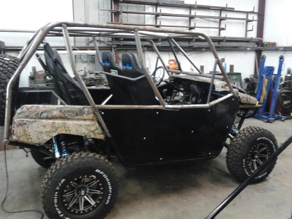

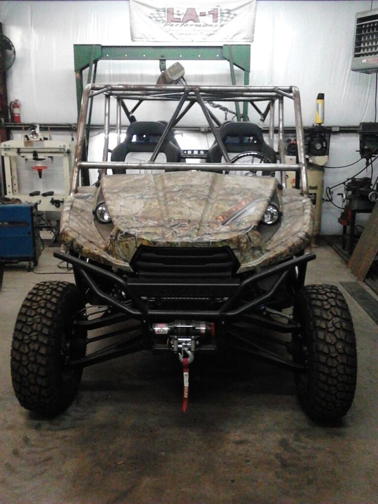

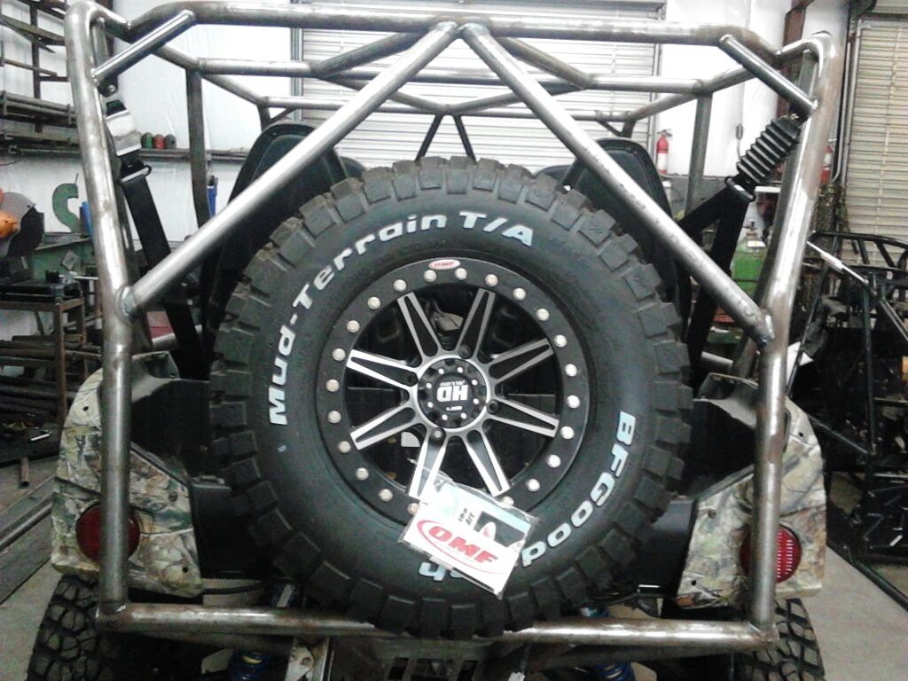

Ok a year later and some real progress. LTI long travel. BFG KM2's in beadlocks. Custom cage and doors. Next up replacing all the plastic dash and engine cover with aluminum. And wiring for intercom, radio, 30" light bar, push button ignition, second battery, and other stuff to make it race legal.
This has been a challenge but I hope to make the first race of the season in April then do the bbk before the next race.

Should be picking her up this weekend. Plan on taking it out for a quick spin then pull the motor and send it to Benchmark performance for the very first 840 BBK with ported heads and oversized valves. Pretty much the works!

I picked my car up this morning. Here are a few pictures. I'll get more when I get back from hunting. Quick test run had a max sped of 65 mph with the wind. Against the wind it was 55 mph. It was only pulling 7200 rpm though and has more power up higher. This is with 30" bfg km2s, muzzys exhaust, benchmark reflash, and v force John machined secondary. I'm planning on testing Benchmarks 840 bbk with the works as soon as possible. But it at this point clutch tuning would yield more good gains. If only someone made a kit (hint hint)!
