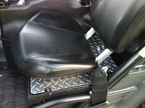

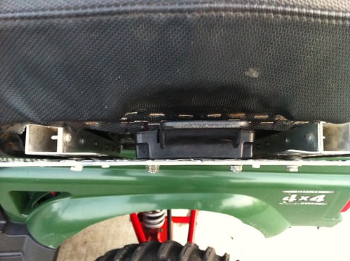

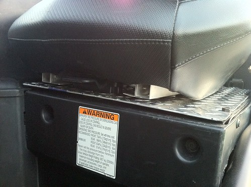

My bases are made out of diamond plate cut to the same shape as the stock bases. I am having trouble loading pics I can load one per post so I'm going to make three posts sorry

Hope that helps. If you use the stock bases it actually limits your leg room more than the rhino seats if you build some bases like mine it gives just the same or a little more than stock leg room.
So it looks like you can just bolt them right to the base? I'm only 5'6" so I actually wouldn't mind being a bit closer rather than more leg room.
