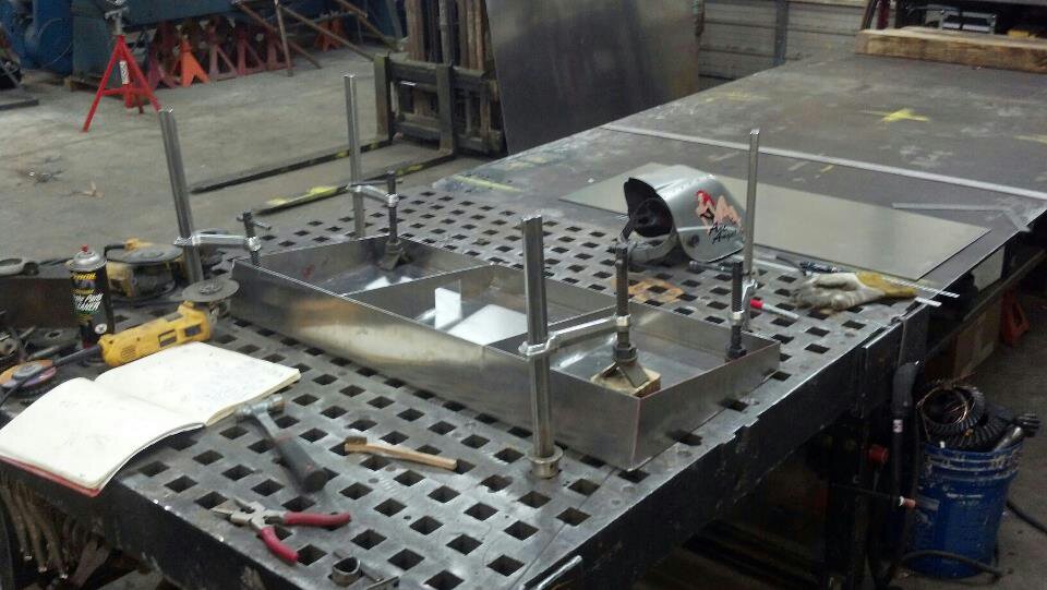

Fuel tank in progress at DrewFab
Found Drew Herdeman's work on rzrforums in guys build thread and I called him up to work out a plan for my fuel tank.
Check him out at Drewfab.com
Yes that was the plan, Maybe help it not push in the corners, It ended up being almost 8 gallons, we will see how it works out. I did stand the front shocks up some also to keep them from "giving up" once they get to compressing. Sounded good anyways.
