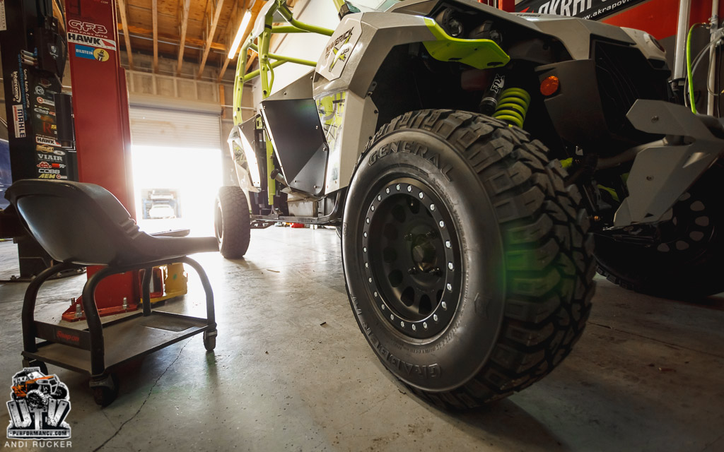

Check out the new tires and wheel set up...
We installed:
1. Method Race Wheels - 15" 401 UTV Beadlock Wheels in Matte Black
2. General Tires - 30" General Grabber M/T's (currently not available to the public)
See for yourself...
See more details here.
