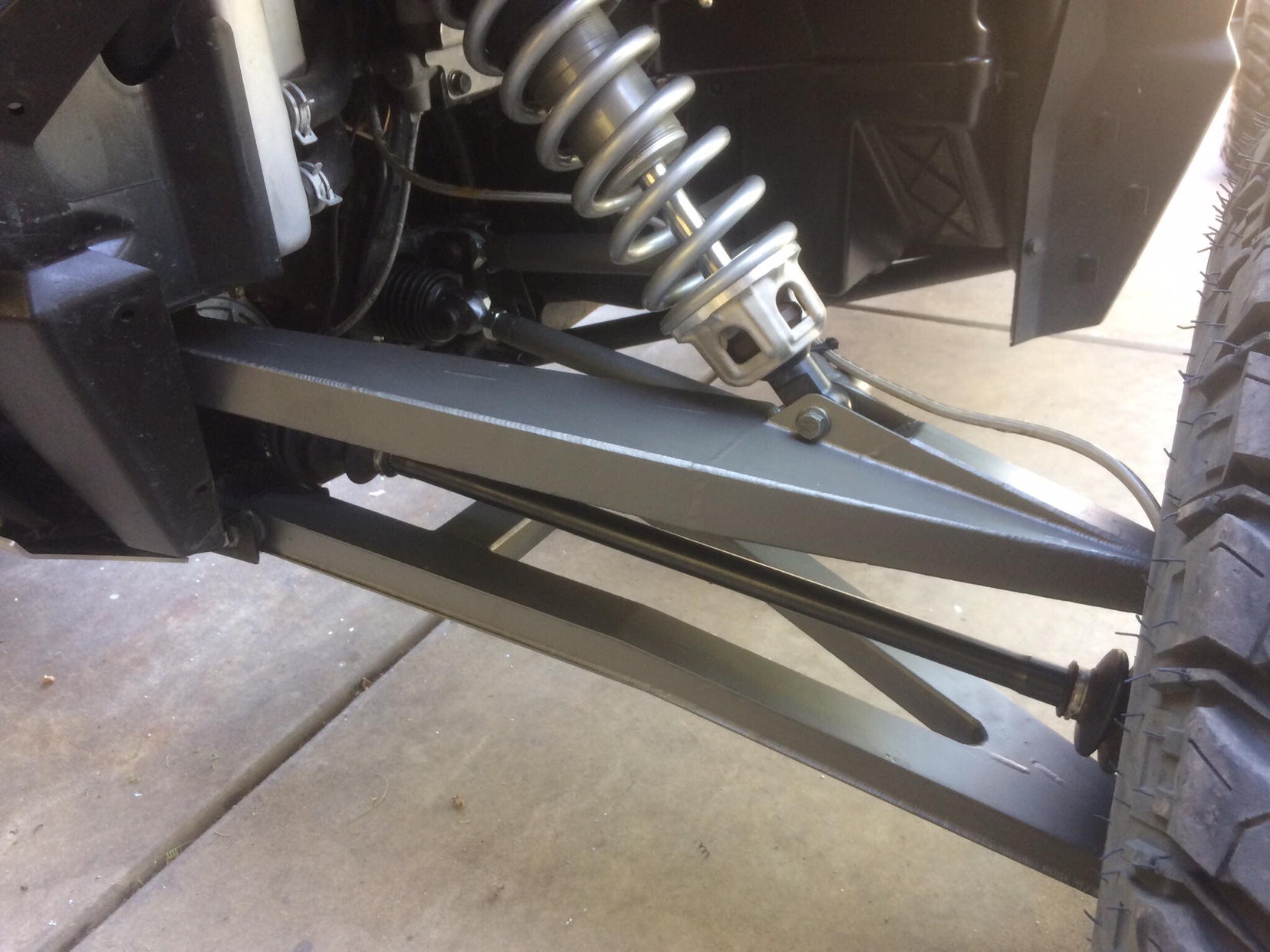

Some arms I coated with steel-it. Looks great in person
just an fyi.
