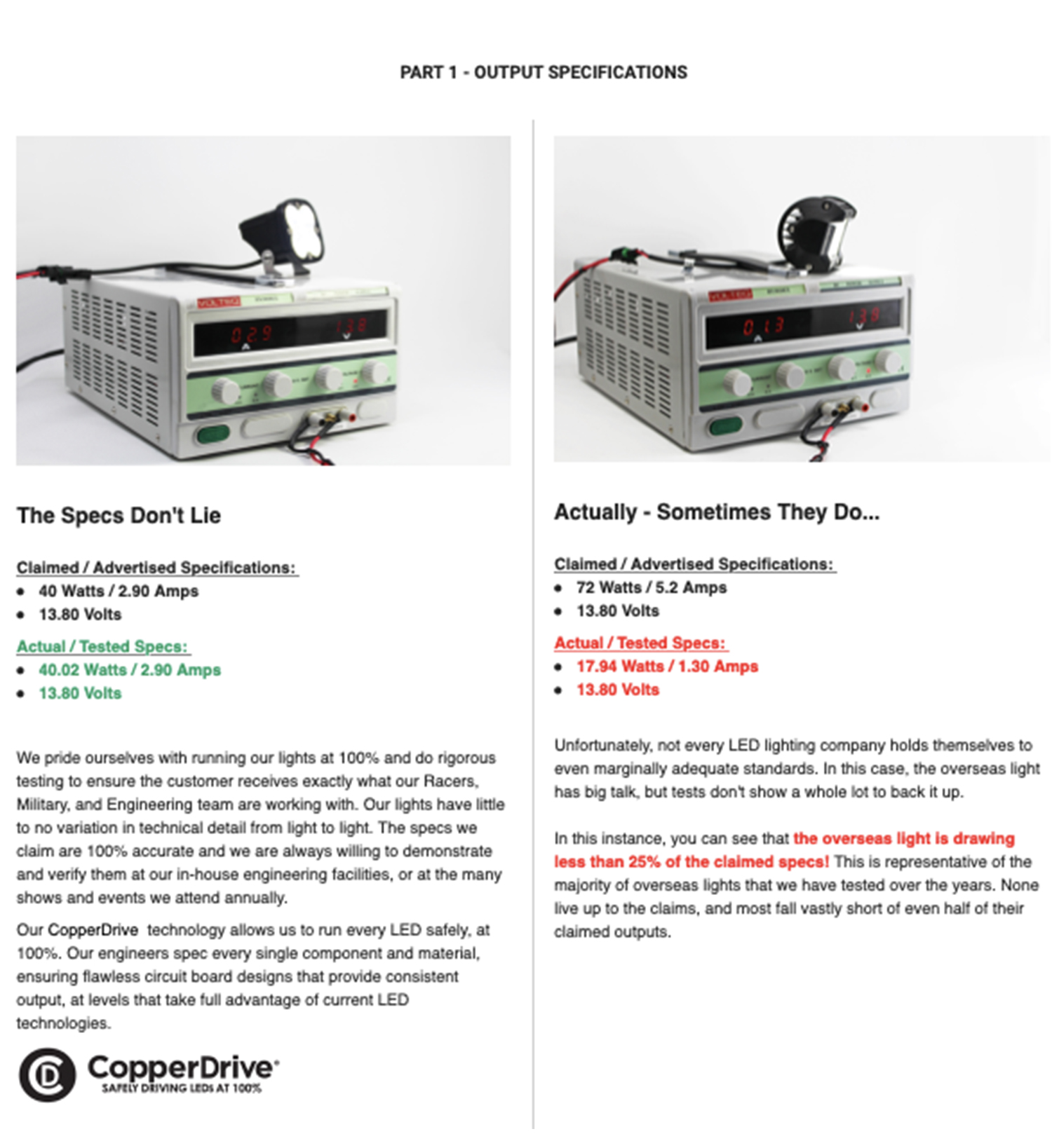

Not All Lumens Are Created Equal - Especially When Others Are Lying
In a multi-part series, we will be breaking down what separates Baja Designs from the imitators, fakes, and clones. Check back often for updates!
