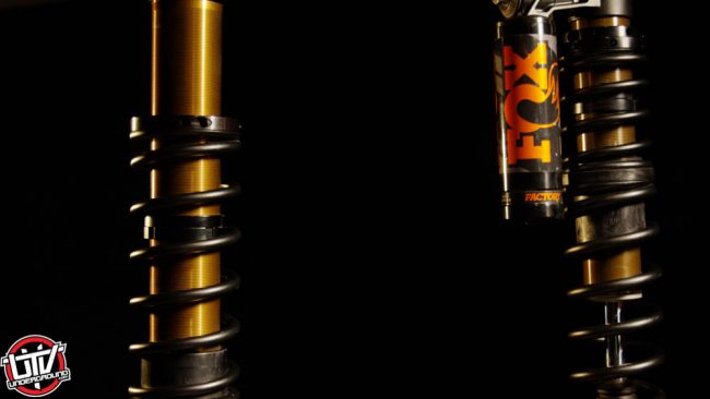

Fox Factory Holding Corp. (NASDAQ: FOXF) (“FOX”) today announced an all-new, specifically tuned, aftermarket shock package for the 2014-2018 Polaris RZR XP1000 2 & 4 seat lineup. The suspension package will retail at $4995.00 for a set of four shocks and is scheduled to be available for purchase this Fall through FOX’s authorized dealer network.
Bred from the same race-proven, FOX patented Internal Bypass technology that has claimed countless UTV desert racing class wins and championships from Baja to Nevada to Australia, the all-new Factory Race Series Podium Internal Bypass RC2 shock package brings the next level of performance to the RZR lineup.
After several years of success racing in the desert with the original Podium Internal Bypass DSC’s, FOX engineers teamed up with desert racing’s top UTV drivers through their RAD (Racing Applications Development) program in an effort to stay ahead of the competition. Developed in combination with and torture-tested by UTV desert racing champions in the harshest terrains and conditions imaginable, the new shock package has been thoroughly proven to deliver racing-level performance and reliability in a fully re-buildable direct replacement, bolt-on package for the Polaris RZR XP1000 lineup.

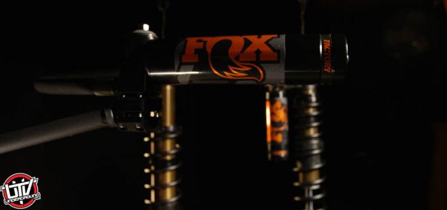

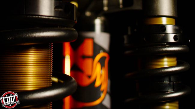

Originally built from the same parts found on full-size off-road race vehicles, the first generation of Internal Bypasses we constructed from steel inner and outer bodies – strong, but heavy. With the UTV classes having restrictions on power, weight is extremely crucial. By developing an all-aluminum inner and outer body construction, FOX was able to shave over 20lbs of unsprung weight from the shock package, resulting in less stress on the suspension components. The aluminum bodies also dissipate heat more efficiently and feature Genuine Kashima Coat for added durability and an exceptionally smooth feel.
Just as the original RZR Internal Bypass package featured dual rate springs with adjustable preload and crossover, as well as Dual Speed Compression (DSC) adjusters, the new Factory Race Series 2.5/3.0 Podium Internal Bypass RC2 package includes those same features and adds wide range rebound adjustment for even more control.
While the all-new Factory Race Series Podium Internal Bypass RC2 shock package was developed for racing, the high level of adjustability and Internal Bypass position-sensitive damping technology has been designed to deliver the ideal ride for every driving style or terrain, whether you’re racing through the desert, cruising trails, rock crawling or playing in the dunes.

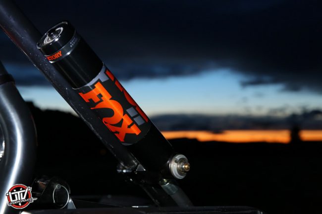

– NEW aluminum inner body, outer body & reservoir provides 20lb weight savings and increased heat dissipation over previous all steel Internal Bypass design
– Genuine Kashima Coat provides exceptionally smooth feel and extreme durability
