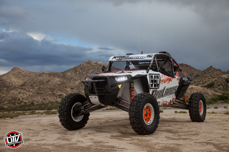

When we first laid eyes on this amazing race machine we knew we had to share it as a feature vehicle. The design, craftsmanship and overall appearance of this Polaris RZR is nothing short of amazing and it performs as good as it looks! We hope you enjoy geeking out on it as much as we do.
SPECIFICATIONS
Model: 2016 Polaris RZR XP4 Turbo
Owner / Driver: Ryan Laidlaw
Chassis: Chromoly tube chassis Designed, Engineered, and Built by Red Lands Racing
Suspension (Front):
-Red Lands Racing custom built long travel suspension
-Red Lands Racing custom built front steer conversion
-Red Lands Racing built Knuckles, tie-rods, and bump steer bracket
-Custom Length 2.5’’ Internal bypass, Fox Shocks
-PAC Race Springs
-Custom Valving and Tuning by Collins Motorsports
-Custom Length Turner Cycles axles
Suspension (Rear):
-Custom Length 2.5’’ Internal bypass Fox Shocks
-PAC Race springs
-Custom Valving and Tuning buy Collins Motorsports
-Lone Star Racing sway bar and links
-Custom Length Turner Cycles Axles
Engine: Polaris Pro Star XP Turbo
Intercooler: CBR Performance Inter-cooler
Radiator: CBR Performance Radiator
Fuel Cell: Harmon Fuel Cell
Exhaust: Red Lands Racing custom built Exhaust
Intake: UMP Intake
Clutch: Airdam Clutches Custom clutch tune
Lighting: Heretic Studios
Skid Protection: Custom Skid plate by Red Lands Racing
Steering Wheel: Joe’s Lightweight steering wheel
Seats: NRG Carbon fiber Race Seats
Safety: Mastercraft 5-Point Harnesses, DJ’s Safety custom window nets
Communications: PCI Com Link 10 Elite Race intercom, Kenwood 50 Watt Race Radio
Race Air: Rugged Radios 4.2 Race Air
Navigation: Ipad Air, Mob Armor case and LeadNav GPS software
Wheels and Tires:
-15’’ OMF Performance Ultralight Bead-lock Wheels
-32’’ ITP Ultracross Tires
Sponsors:
ITP Tires, Fox Shocks, OMF Wheels, Turner Cycles, Airdam Clutches, PAC Race Springs, Collins Motorsports, and UTVUnderground.com

Day late and Dollar short. These pictures of the RedLands car are already 1 Generation behind. These guys dont rest and just think, what they have today is the best it can be. Since these pictures were taken they have completely back halfed the chassis and re-engineered it, along with both the front & rear suspension components. They dont rest, and even the fuel cell placement is looked at for improvement. If they find a way to do so, a new cell is made and mounted in the car. I have yet to see the dedication from any other UTV team to continue to push the envelope and try new things. Just look at the parts break down on the list above, you dont see many aftermarket brand names listed. That is because they are dedicated to building everything in house and better then what you can buy over the counter. You also are only seeing what they want you too. Like the steering, that in itself was a huge feat! The engineering that goes into building the a-arms and trailing arms is like nothing another UTV team has done. They are built the way suspension parts on class 1's and TT's are done.
The RedLands Team has a Instagram page that will allow you to see a bit more of this truly one off race UTV. There lead fabrication Parker Garrett who has recently passed away, also has some amazing fab pictures of this amazing machine in his Instagram. Parker not only worked for the Red Lands crew, but also helped build and fab for TSCO racing and their newest TT's which Andy McMillin is currently driving. (You know the truck that won V2R!) RIP Parker, you are missed!

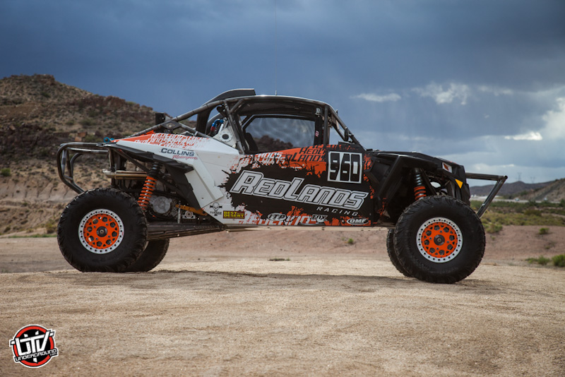

Since the beginning of this project, the car has been in almost constant evolution, which I think makes some people (at times, myself included) scratch their heads and wonder if we have lost our marbles. I think part of the reason that we have continued changing things simply relates to being a young team (2nd year racing and our first total car build) where at times it has been a situation of, "You don't know what you don't know" so we have been riding the learning curve. Another cause has been the basis of the project--which was to redefine the envelope in which a desert UTV operates. When you push these boundaries often things don't work out on the first attempt. It has been stated before, trick parts=trick problems, which is very true. We have been forced to develop solutions to issues that are entirely unique to our build, and at times these solutions have required system level changes. With that being said, it is also true that trick parts=trick performance. The car is gorgeous, I agree, but that isn't even the best of it. Photos (and even video to some extent) have difficulty capturing what it is capable of, which for me has been pretty jaw-dropping.
At the end of the day amazing performance does not equal success, just like horsepower does not win desert races. It is reliability. Justin and the whole Cognito team have demonstrated that axiom perfectly this season (keep it up guys!). Ryan and I had a conversation a few weeks ago and we both had this same conclusion. We feel like to have a shot at consistently putting this car on the podium we must focus on reliability, and to do that means stop changing stuff! So I expect the rate of change to slow down. There are still a couple surprises up our sleeve that have been in progress since LDC, but for the most part the car is there. We will be ready for BWDC!

They were lined up right in front of us at tech for V2R. I don't think you could have any more of a stark contrast to approaches as our two cars. While we went for the full out, no hold barred approach to our build, the cognito car is about as simple as it gets. Sure they did a full chassis but what you won't find on their car is all the latest bolt on shiny bits. Everyone else in the series is trying different sway bars, adding front sway bars, billet this and that. If you want to check out the K.I.S.S. principle, theirs is the prime example.
I assume the shock stroke has been increased to 10" in the front, 14" in the rear? Can you confirm?
Shock stroke was increase, motion ratios were improved but unless Ryan is feeling especially generous, you won't get any specifics. Its like asking a girl how much she weighs. If she wants you to know, she will tell you. But if you ask....

It did win its maiden voyage. Not many can say that. Cognito has so Redlands is in good company! We also missed the first race of the year so our strategy has been a little different than most racers. Being out of the points race, each race has been an opportunity to see just how far we could push the envelope. Anyone that has been close to us in the Fox proving grounds knows what I'm talking about. Pushing the limits has ment we have broken some stuff which is part of the reason the car has been been reworked a couple of times making things better. The car also led most of the first 2 laps at the Mint until a belt let go and the car came to a stop on top of a bush which gave way to a very long belt change. At one point in V2R, Ryan was ahead of the Murrays but a tool failure at pit 11 caused a series of events that led to a clutch having to be delivered and changed out on the course. The car has the speed and performance to kill it but like Eric said, we are a new team and have been learning the lessons each race that a very successful team like Cognito has already learnt over the many years they have been racing.
