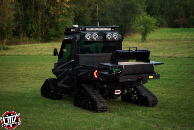

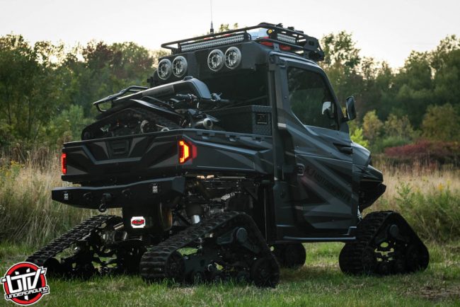

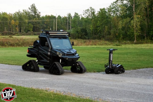

The Bed System
KJ Motorsports teamed up with SlideMaster to incorporate an interchangeable bed slide system for the Ranger. The system provides three different options to accommodate some awe-inspiring items for your time on the trail. The first option, a Shredder carrier! The DTV Shredder (http://bpgwerks.com/) is a single person, stand up, tracked vehicle which is wrapped to match the Ranger and is perfect for playing around the camp site or hitting trails too tight for UTV’s. The second option, a propane gas grill and we’re not talking about some cute little toy you pick up at your local big box store. We are talking about a full size, professional grade, stainless steel grill that is powder coated black to match the sleek look of the unit with enough grilling space for any size crew. The third option, a full size cooler mount that easily accommodates a 70 quart cooler. Let’s face it, we all get thirsty on the trail and the TrailMaster is definitely the machine you and your crew will want to gather around to enjoy the 2,000 watt sound system while quenching your thirst.

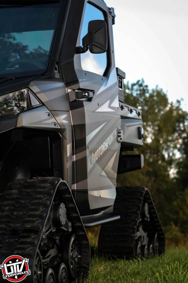

With the tracks in place KJ Motosports upgraded the driveline to accommodate them with ease.
A bullet proof transmission from Gilbert Designs with turf mode delete, double reverse chains, SKF bearings, upgraded output shaft, HD bearing retainer, cryo treated gears, and case gussets were installed on the TrailMaster. Accompanied by QSC Rev-X billet primary clutch & secondary spring, Gates G-Force carbon belt, Turner Cycles Billet Front Differential & Level 2 axles, Level 2 Upgraded rear axles, Wicked Weasel Fabrication Billet 5 Finger Armature Plate for front differential, and RVS Performance Stage 1 – 91 octane ECU re-flash were all also a must to confidently put all that power to the ground through the MattTracks this tank rolls on.

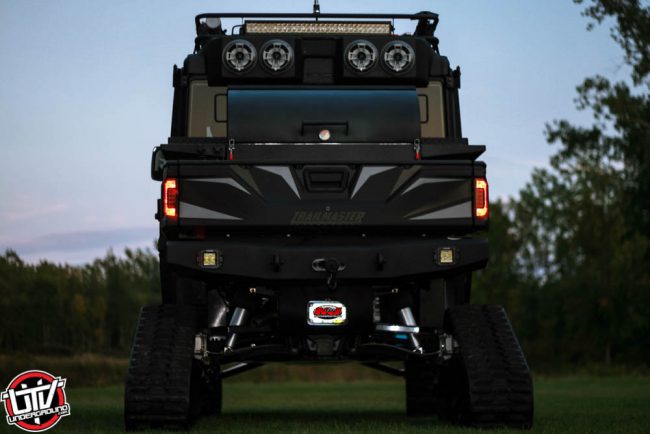

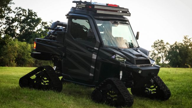

When the beef isn’t on the grill there is still plenty to be found all over this Ranger. The RuggedPRO Bolt-on Front & Rear Frame Brace Kit developed and sold by KJ Motorsports is installed for that additional support these machines are notoriously in need of. Super ATV Black High Clearance Boxed A-Arms in front and rear help the machine achieve its monstrous stance and add durability. Also from Super ATV, Wrinkle Black front and rear bumpers provide even more beef to the machines look, with the rear bumper modified to house and cover a KFI Assault series 5000 lb winch hidden inside. Another KFI Assault series winch is located in the front bumper, with a custom made bumper to skid transition plate that seamlessly mates them together. RackBoss Heavy Duty Rack and Pinion and 1/2″ UHMW Skid Plate round out the upgrades from Super ATV found on the machine.
Storage
A heavily modified safari rack is mounted atop the cabin and is packed full of necessities for the trail. RotopaX 2 Gallon Water Pack and 2 Gallon Gasoline Fuel Pack ensure you will not run out of gas or water. A 2lb fire extinguisher with Axia Alloys mounts, CKRT 104491 Trencher folding shovel multi tool, and Hi-Lift 36” ATV/UTV jack with Black Jack handle keeper can also be found on the Safari rack. The TrailMaster also has a custom made, diamond plate aluminum storage box in the bed with enough space for anything else you may want to take on the trail.

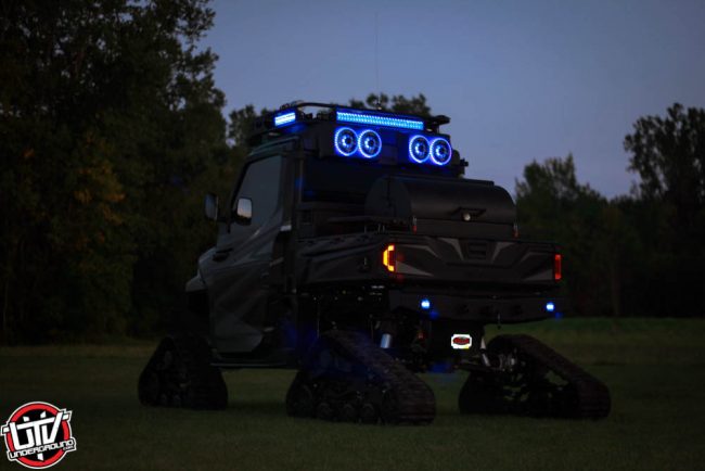

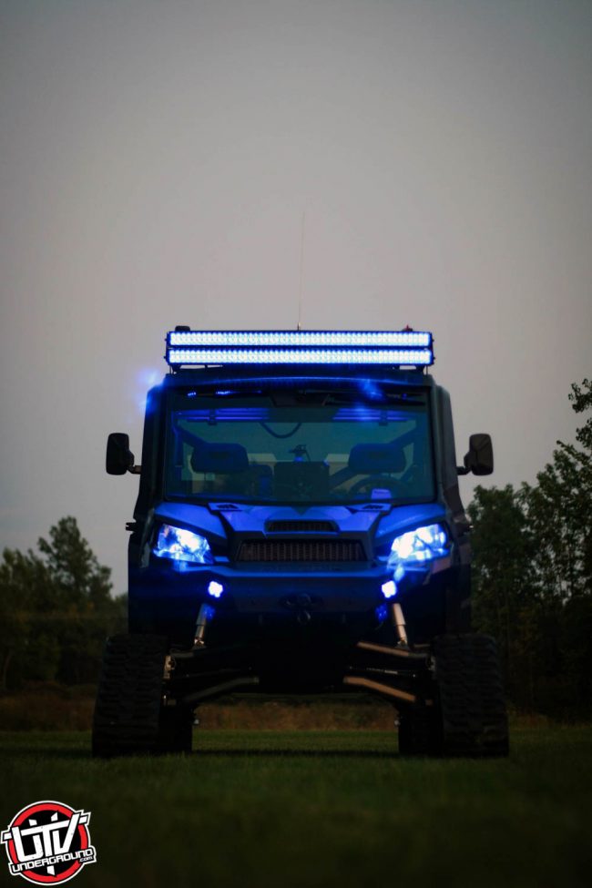

Lights and Sound
The TrailMaster features a tasteful yet powerful set up in both the lighting and sound departments; with the battery box fully customized to house two Odyssey 75-PC1230 Extreme Series Drycell Batteries, with a 3rd Odyssey PC680 Extreme Series Drycell Battery reserved for starting to ensure all systems have plenty of juice. Rogue4 lighting is in place with all backlighting on the machine set to blue. All mounted to the Safari rack; two forward facing Delta Series 50″ RGB LED Combo Light Bars, rear facing Delta Series 30″ RGB LED Combo Light Bar, and Delta Series 10″ RGB LED Combo Light Bars on both the driver and passenger side. In addition, two Bravo Series Flush Mount Mini RGB LED Flood Lights are found in both the front and rear bumpers to provide additional ground illumination on the trail. XKGLOW 2 in 1 LED Headlight Bulb Kit is also installed with the XKchrome Smartphone App-enabled Bluetooth RGB Demon Eye and LED headlight conversion to complete the TrailMasters 360-degree lighting scheme.
The sound system of choice on this build is from Audioformz, with a custom roof unit located on top of the cab. You will find eight Audioformz 6.5” speakers with LED rings and cones all set to blue as well. Four speakers on the outside, four on the inside, and an SSV Works Polaris Ranger XP 900/1000 Under Seat Sub Box with Rockford Fosgate Punch 10″ P3 2-Ohm DVC Subwoofer is installed to provide some additional low end boom.
The Punch Marine Hide-Away AM/FM/WP Digital Media Receiver is hidden in the roof with Rockford Fosgate PMX-1R Punch Marine/Motorsport full function wired remotes with 2.7″ displays installed in the dash and on the driver’s side of the cargo bed for control from outside while chillin’ and grillin’. Four 500 watt Audioformz amps power the system yielding a total of 2,000 watts with over five feet worth of speakers pushing air!
