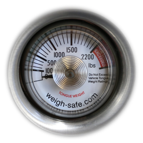

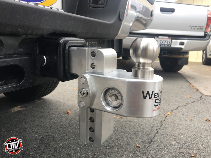

If you see the Weigh Safe hitch from the passenger side, it appears to look like the other adjustable billet drop down hitches on the market. But what caught my eye was the cool built in scale that is positioned directly on the ball mount on the driver side. I quickly realized this wasn’t an ordinary hitch and clicked the ad to learn more. The built in scale ensures proper hitch weight making for a safe towing experience. In my early years I learned the hard way that too much weight positioned at the rear made the trailer sway from side to side and the faster I traveled the worse it got making for a very dangerous situation, not just for me but for others on the road. Too much weight at the front of the trailer (tongue weight) and you can overload the tow vehicles rear tires making the handling of the truck difficult while reducing your ability to stop or corner at speed.
With experience I learned that trying to keep the weight centered or over the axles of the trailer almost always made for a good pull down the highway. But there are times when I have multiple vehicles on a trailer and thats when things can get a little trickier as visually things look good but not until I get going at speed do I realize that I should have backed one vehicle on in reverse or actually flip flopped the position of the vehicles entirely in how I loaded them. The Weigh Safe hitch now takes out all of that guess work, allowing you to instantly see if your tongue weight is perfect for towing. No more trial and error, and no more getting down the road and just saying the heck with it and keeping on because you don’t want to deal with pulling over and resolving the situation. Simply put, the pressure of your trailer on the Weigh Safe ball sends a reading to the scale, measuring the tongue weight in lbs.

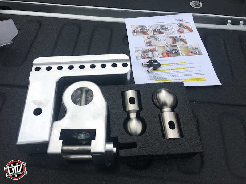

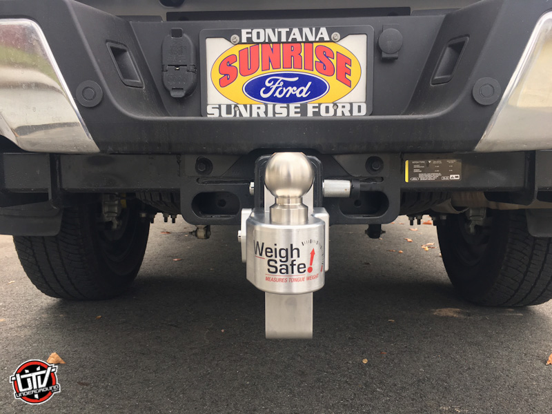

I was instantly sold on wanting this hitch for our new Sunrise Ford F350, we placed our order for the Weigh Safe hitch and we were stoked to be able to get their 6″ drop down (available in 4″, 6″, 8″, 10″) with 2.5″ receiver shank. Whats cool about our new 2017 Ford is it has multiple receiver sleeves allowing all the way up to a full 3″ shank. Weigh Safe will soon introduce a 3″ hitch which will allow us to actually tow 21,000 lbs, the full capacity our truck is rated for! Needless to say, once its released we will be upgrading and swapping this 2.5″ hitch to our older diesel. The maximum Gross Tongue Weight (GTW) for our 2.5″ hitch is 14,500lbs with the 2-5/16″ ball mounted on it. Its rated for 10,000 lbs with the 2″ shank so you can see quickly how much that larger receiver actually adds to the weight you can tow with. The hitch is also supplied with a smaller 2″ ball which can be installed simply by unlocking and removing the pin in the ball mount. With the 2″ ball you have a maximum GTW of 8,00lbs. The hitch in total is rated for 2,200 lbs of total tongue weight.

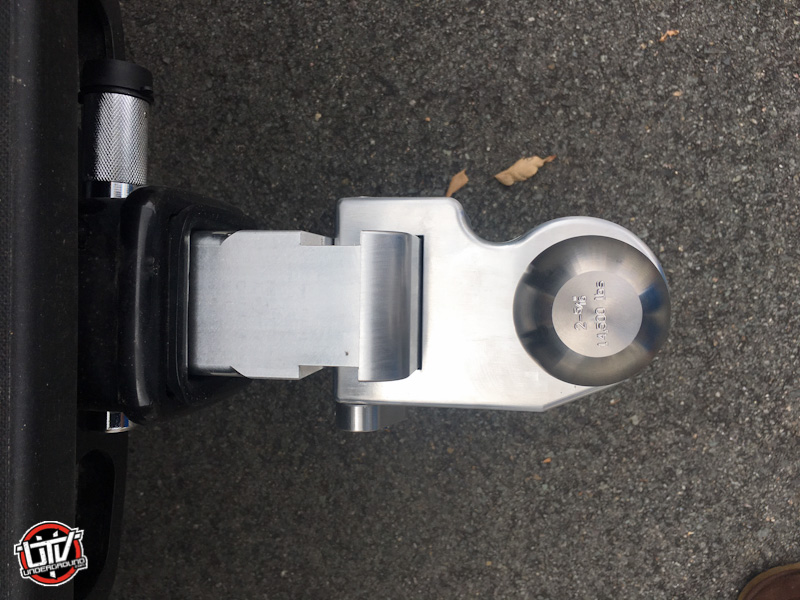

The hitch is made of high quality aircraft aluminum and uses only high quality stainless steel components. Everything is CNC machined in house at Weigh Safe’s facility here in the USA. Weigh Safe prides itself on being the safest, and highest quality hitch in the industry and seeing it leaves little doubt in my mind that it isn’t the nicest hitch on the market. The parts fit with precision, the ball mount slides effortlessly on the drop down and the pins fit securely without having to fight them in and out of the predetermined holes. Adjustability is king when towing different trailers like we do. We have one trailer that has flipped axles that we will raise the ball mount up for while others we will slide it down due to the ride height of our truck. Another feature is the ability to flip the ball mount around into a “stow away” position and anyone who has smashed their shin into a hitch while walking behind a truck will know just how cool that feature is.

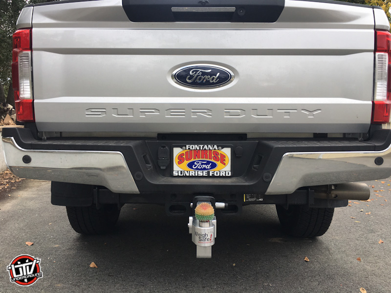

Once we got our hitch installed we greased it and found an old ball (dog toy) and turned it into a cover, a technique my grandfather would be proud of. Next up for us is to actually put it to work and we can’t wait to bring you more info on how it works and holds up to our heavy duty towing duties.
