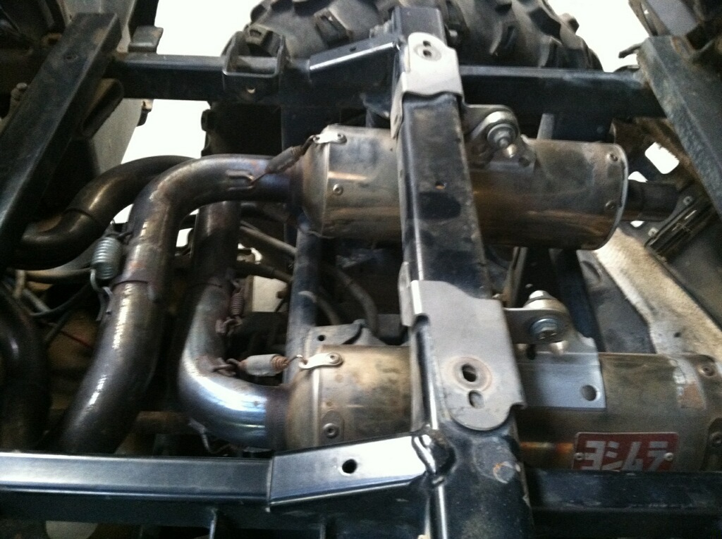

Purchased this rhino for my fiancé since when we go to the dunes she sits at camp and read while we ride, picked it up for 3900 07 special edition 660 260 hrs little over 1,xnxx miles , I purchased from a guy a complete yoshimura dual exhaust system complete , 686 big bore kit needs a new piston, gave me some jets, a filter kit to eliminate the box and use a unifilter , and a filter set up for the crank case all for $100 bucks , I plan on replacing the exhaust system whole reason I made this this purchase for that, cause my stock ones are loud from exhaust leaks seen weld marks on the pipes, the filter set up, I don't know about the big bore kit, I'm afraid to do the swap and become a headache later, and if it's even worth the power , as far as the jets I seen one that says 55 and the other a possible 170 and has a needle too and if I should mess with the jets . Thanks

Ok then I'll leave it out, dual yosh pipe complete system, with filter box eliminate kit, with unifilter should I rejet it?
If you are going to run that pipe with an air box delete filter then yes you should rejet. That's going to take some trial and error to get right. What elevation do you ride?

The reason I'm replacing the stock exhaust system is cause the owner before must of had an exhaust leak n welded up a bunch of spots now it leaks even worse n sounds like crap , I'm all stock in the rhino besides suspension, I plan on the pipe n headers, the filter kit, then a cdi box but I gotta save money for the cdi I gave everything else
