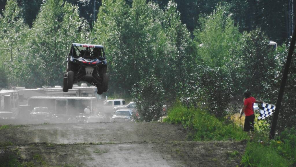

Hey everyone. I'm looking to do some performance work to maverick and I'm wondering what all can be done to increase my HP without bumping me into the unlimited class (no turbos or big bore)
I've finally got machine jumping and handling very well, now I just need a bit more power to get going.
