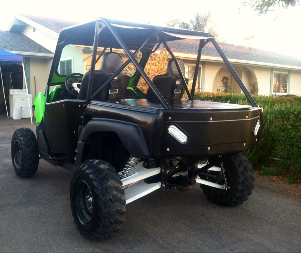

Back at it again. Some of you know that I tumbled the Teryx over Thanksgiving. I destroyed the hood, radiator and windshield. I'm taking the opportunity to reface the machine and get it ready for new years.
I had some good friends supply me with a hood, lights, t4 radiator and fenders. I bought the muzzy hood brackets and did the hood conversion. I had to make some brackets to make the radiator fit. I'm expecting to see improved cooling with the bigger radiator, larger hoses and bigger fan. The factory led lights in the hood are nice too. Another advantage with the newer hood is that it opens! This is gonna make it easier to work on. This is how it sits right now. It should be ready for new years!
