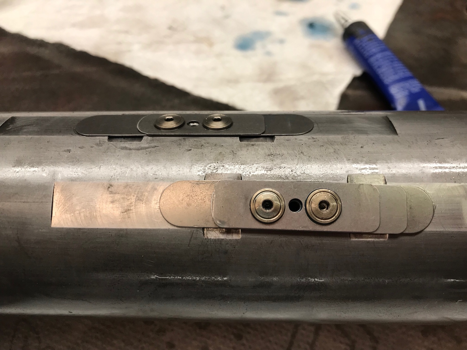

I changed the rear rebound to 1.6x.010, then .012 on the rest. Left the compression alone, except I removed the middle shim from the lower bypass port. I’ve only had it out for 20 minutes, but it’s much improved. I’ll probably revalve it one more time. Here’s a vid of the internals.

I also replaced the 1.8x.015 compression shim with a .012 and cut down two of the bypass check valves.

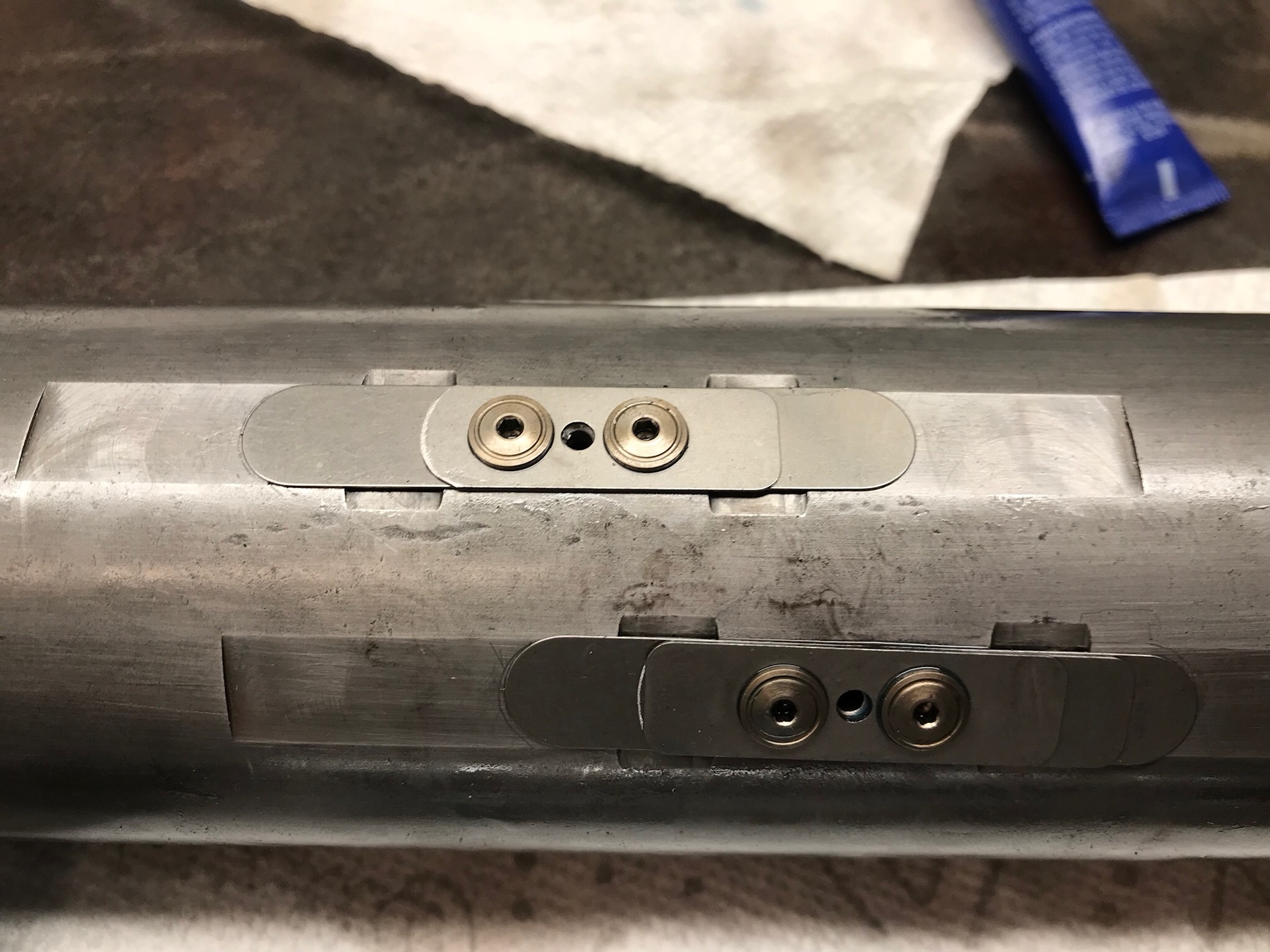

You can see what I cut on the bypass check plates below.
