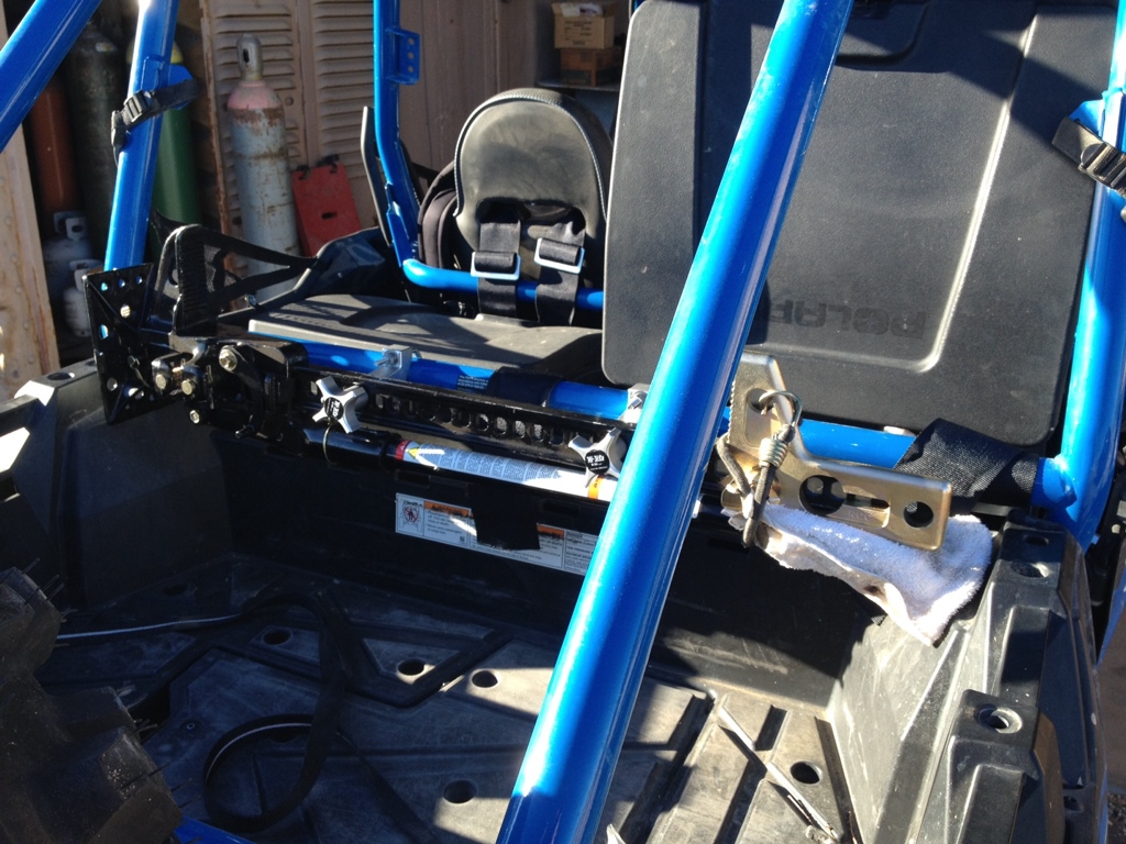

Prob not a good jack for a race but it's a high lift utv jack with their mounts.

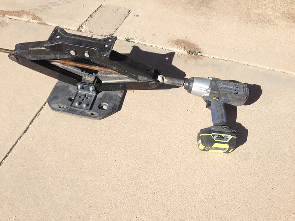

Get a small scissor jack from a small car ad weld a lug nut to the spin shaft then you can use a cordless impact to jack the car up and use the same socket to remove the wheel. Then make a mount on car that you can run the jack tight too to keep it in place. works well

I did what cassey said use the same size nut as your lug nuts, I also welded a nut to the bottem middle use a thread all with bent 3/8 rod welded to it (a big wing bolt), 2 blocks of wood 2/6 with hole drilled for the thread all. bolts together inside the spare. the top of the jack is modified for my cont arms. be sure to test you jack with a flat tire (make sure it works)

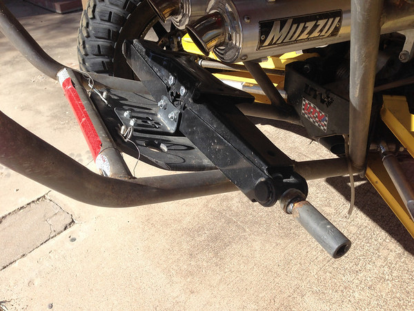

This year we had a highlift style jack from an 80's GM car that is stamped steel and lighter than our scissor jack (that fell off last year). we burned a cupped piece of plate that cups the a arm or the raduis rod and welded on the front. 100% secure and badass, really helped us with out a arm ripped off. Also, it jacked up against the harness bar in the bed and only cage tall didn't move an inch all day.

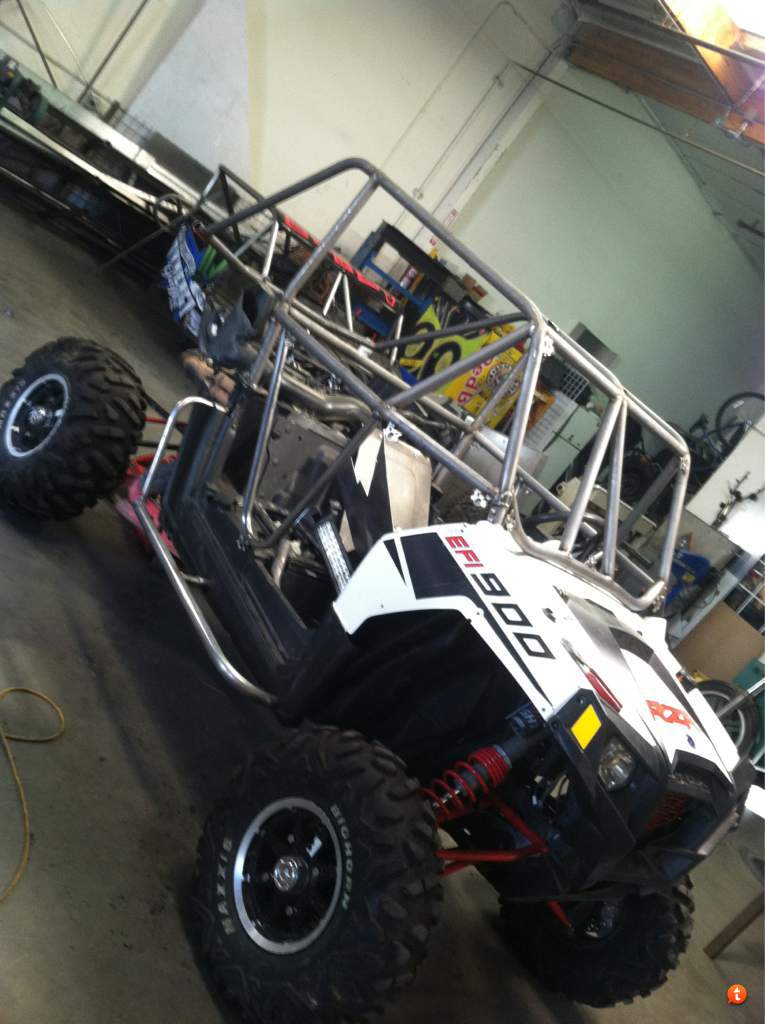

here my cage now. I was thinking(hoping) it night strap right onto the tire.
Looking at the picture I think your good. My down tube had a bend in it so it wouldn't mount. Yours appears to be straighter than mine.
