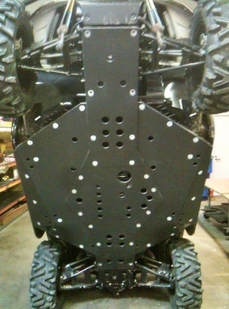

Lookin good woody, how's the T4 for protection underneath?
Are you going to add full skids (does anyone make em yet?)
There is plastic...the 'rocker' area has some sheet metal...and the outer rails are VERY nice tubing...
The plastic appears 'as good' as what was on my RZR...which survived about 3 months before it started shredding...lol

Picked up my T4 at Factory UTV today. They used mine to make the pattern for their UHMW skids. I would recommend 1/2" UHMW for the Teryx4.
