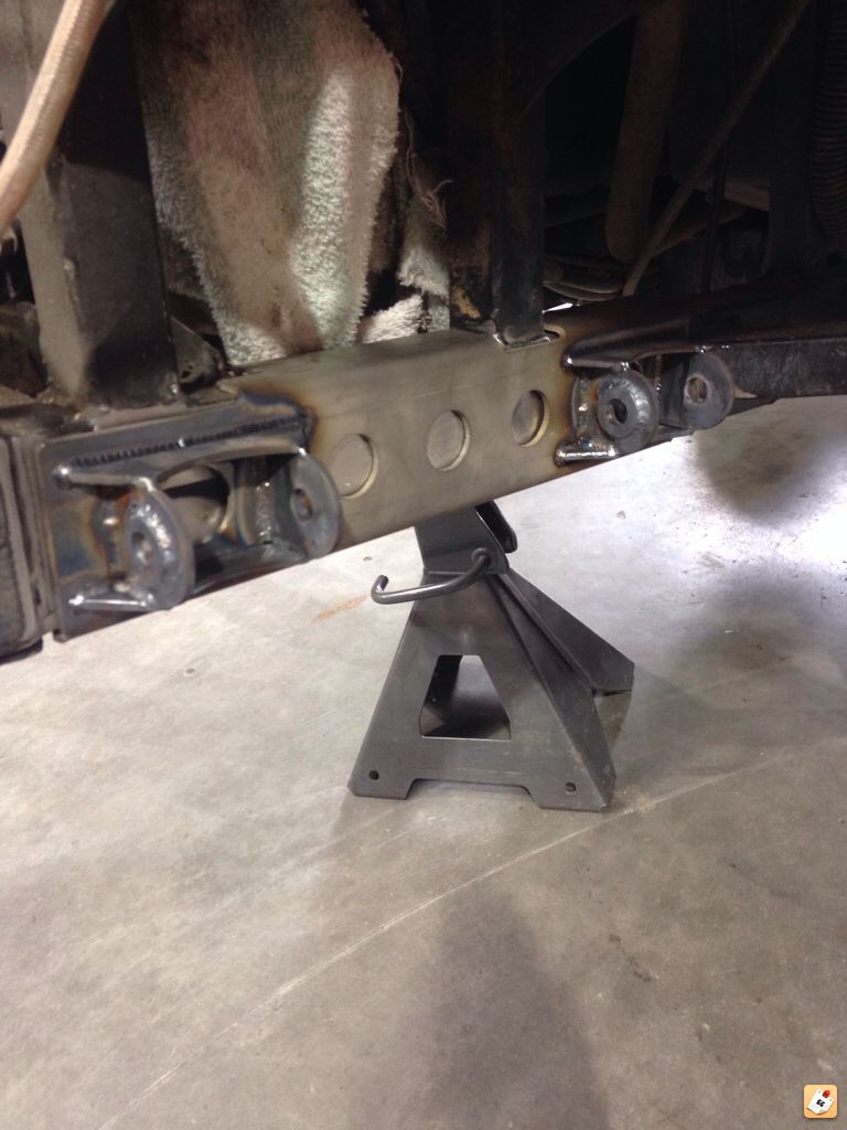

Take it to a frame shop and have it straightened. We have had our Race teryx pulled straight a few times now.
Carr-One was just fixing this Teryx frame when I was in there last week. Anything can be fixed. They pulled the frame straight and made all new pivots and everything. Now it's super strong.
