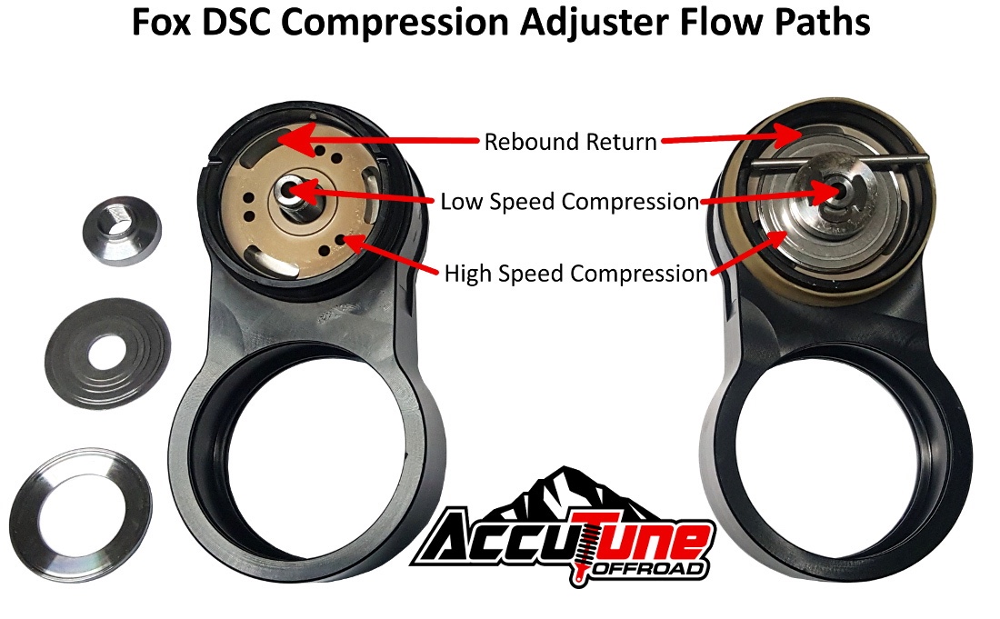

I still haven't been able to figure out what "special " tools are needed. After a lot of googling I did find a couple pictures of two different styles of a tool that is needed to take the compression adjuster apart. I think this summer I'm going to attempt my own revalve. I f I do I'll be sure and share everything I find out along with pictures.
I still haven't been able to figure out what "special " tools are needed. After a lot of googling I did find a couple pictures of two different styles of a tool that is needed to take the compression adjuster apart. I think this summer I'm going to attempt my own re valve. I f I do I'll be sure and share everything I find out along with pictures.

I did a five-minute search right now and couldn't find what I saw before. It literally took me a good hour of searching different parameters on Google images till I found what I thought was the right tool? It's hard to tell because they have mountain bike and motorcycle fork tool also.

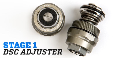

Finally found a tool for the dsc, which is on the race shocks and available as an upgrade for ours.
So I just looked at the compression adjuster on my car, and it just needs a spanner wrench to take it off. Not what I'd call a "special" tool.
