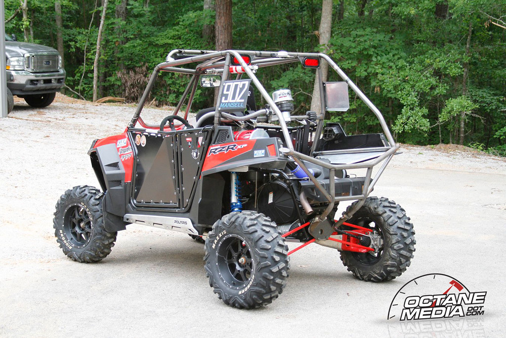

I need upgrade to beadlocks on the RZR XP. I'm looking for low weight and durability, in a 14" wheel. What do you guys recommend?
