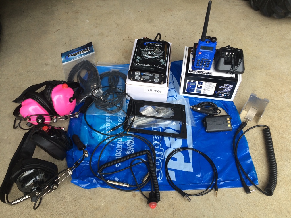

Just thought I would share my setup that I am installing right now.
At dunefest rugged was offering killer deals so I picked up a 686 intercom with behind the head headsets, their 5 watt handheld radio, can-am mount, and all the cables I needed.

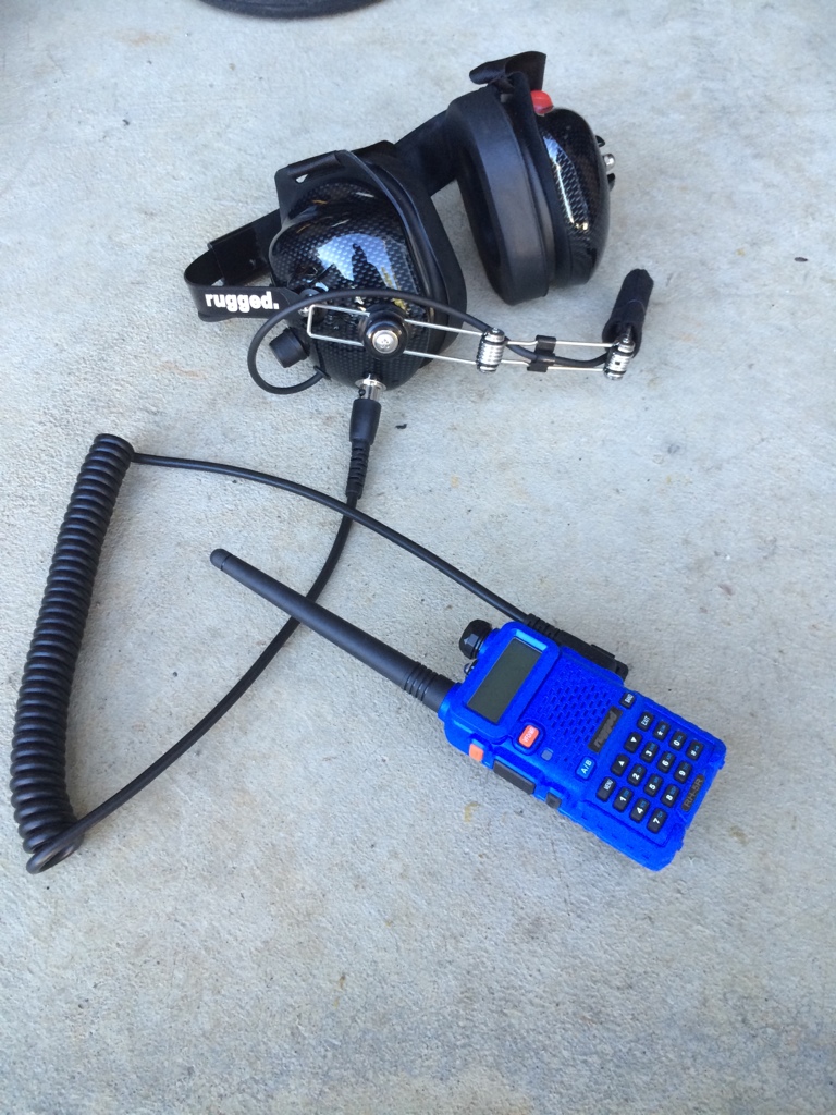

While we were still over there me and two other friends just ran the radios connected straight to the headsets, anyone looking to do it cheaply that is an awesome way to go, you could get the baofeng uv-5r radios and cheaper headsets or helmet kits and run that. We were able to get about a 2 mile range running like that. Pretty good for the Oregon dunes cause you are running in the trees a lot of the times on trails.

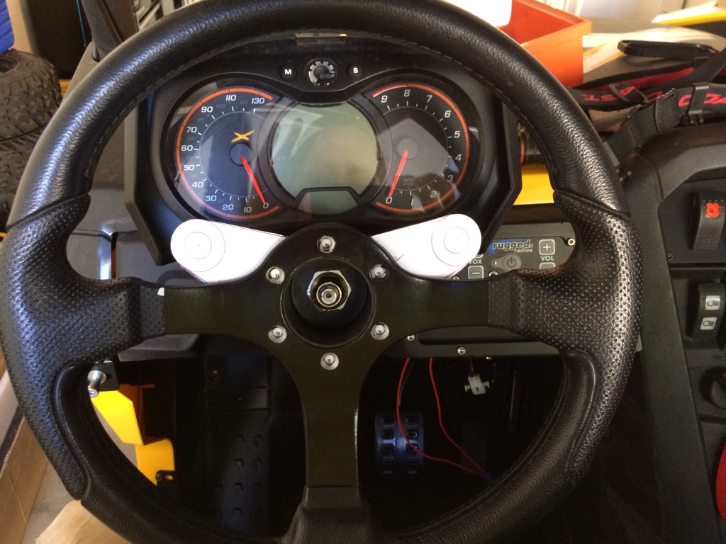

Since we've got back I'm putting in the intercom, and making a mount for two Ptt buttons on the steering wheel, one will be for the radio and the other will be for a horn ( yea I rock a Dixie horn on my maverick). I will mount my 5 watt handheld radio on the left hand side of my steering wheel and am planning on getting an external antenna to run on the roofs to get a little better performance out of it. Eventually I will upgrade to the 50 watt vertex but the handheld will do for now.

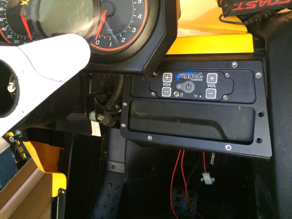

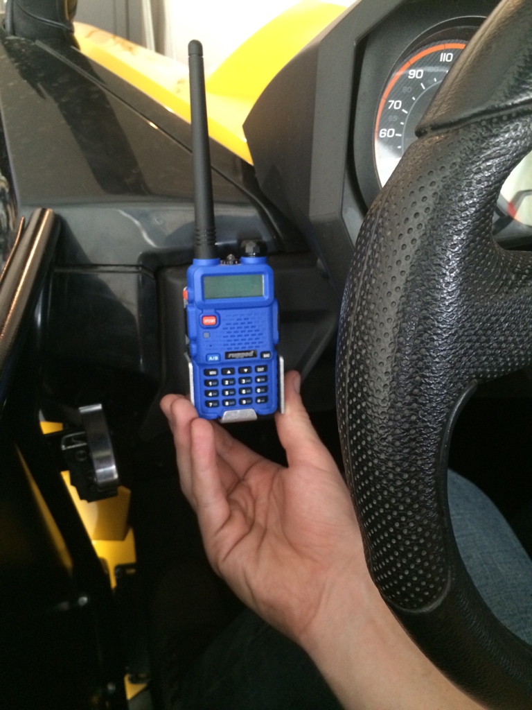

A little update in my intercom/radio install.

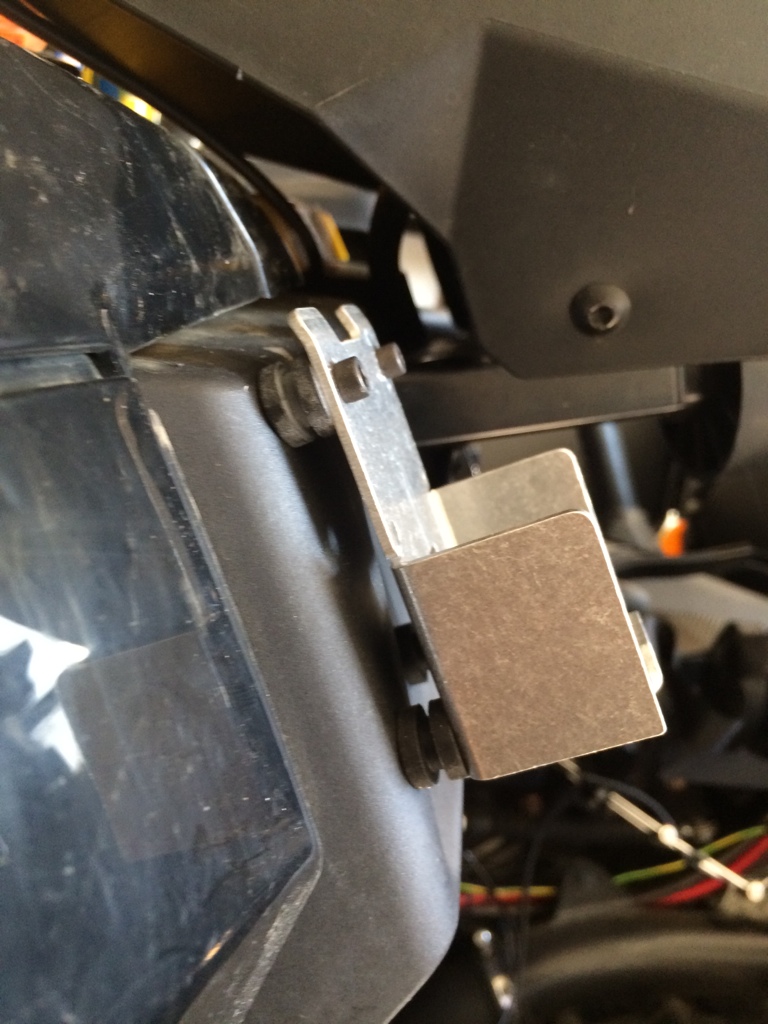

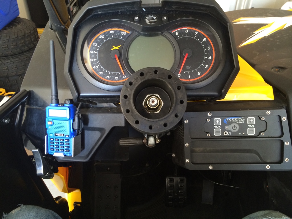

Got the handheld radio mounted. I just used some smaller rubber grommets to space it out from the dash to the radio will still clip on the mount like it it supposed to, worked pretty good.

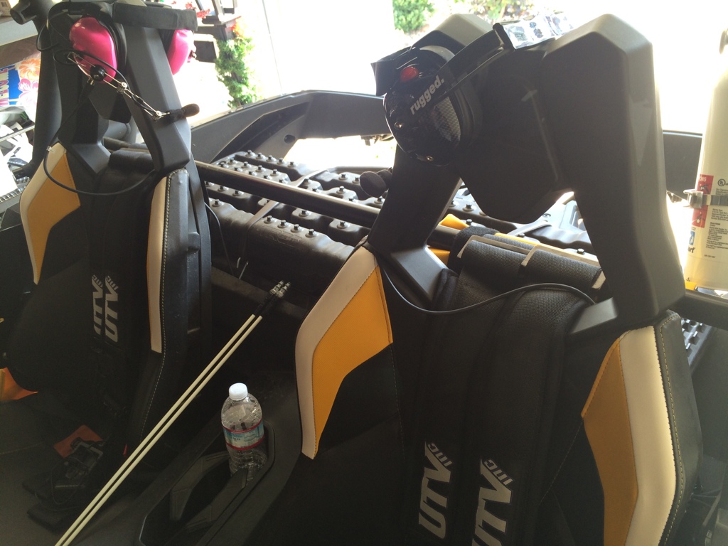

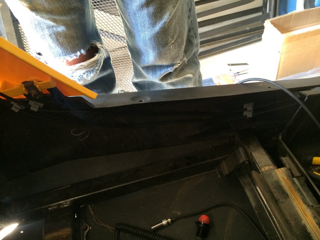

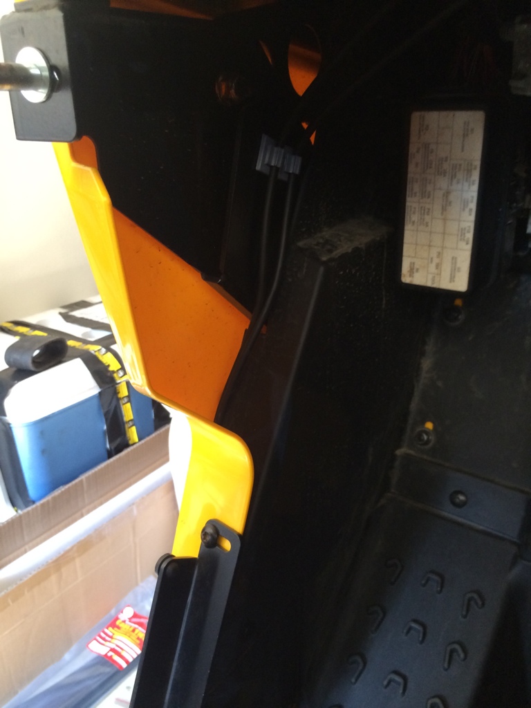

To run the cables for the headsets I decided to go down the driver side rocker pannel to keep it away from the heat of the motor and exhaust. Then brought the cables upright beside the driver seat and ran the passenger cable across behind the plastic between the seat and the rack in the bed area. Found it easiest to run the cables through the headset to kind of keep them contained. Eventually I will upgrade to the cables with their offroad plugs just for convenience.
Only a few things left of the to do list, #1 is cut out my Ptt button mount for the steering wheel( should get that done today), #2 is find a nice sturdy iPhone mount for when my phone is connected to the intercom, #3 is get some sort of external antenna, not really a need I would just like to have a little big more range if I needed it. Most likely won't, when we ride we are never very far apart but it wouldn't hurt to have.
I did play around a little bit with the intercom a little bit. I am very impressed with it, really nice unit. I have my phone plugged into the auxiliary port in the back, so I can listen to music and take phone calls. Talking on the phone over the intercom is very clear in the headsets and the person I was talking to said it was very clear. The music was also very clear and had plenty of volume. One thing I noticed though is it did not cut out when I started talking. I will have to mess with it a little more. But overall I am very very pleases with ruggeds product!

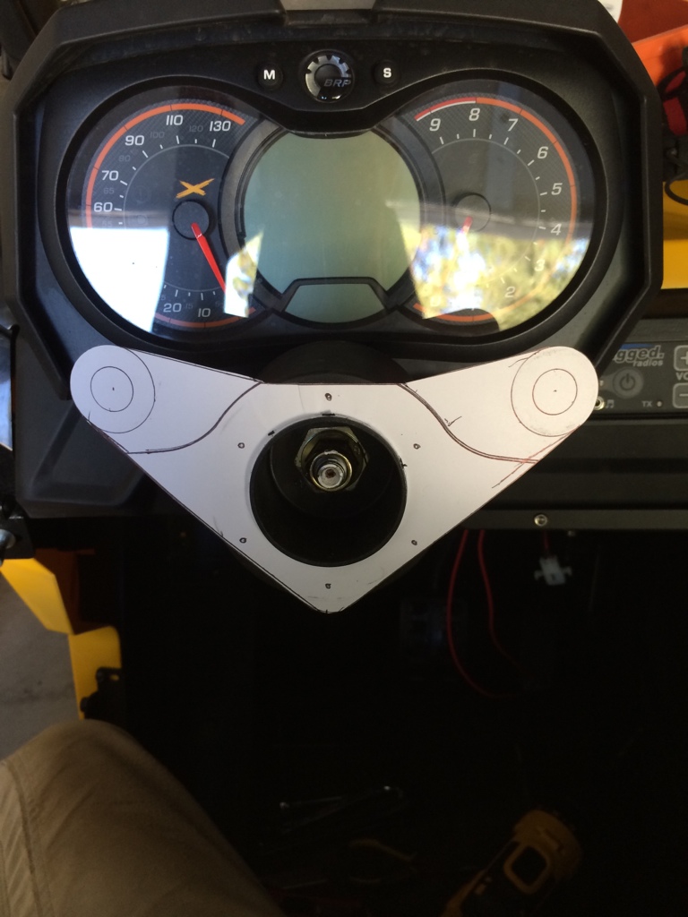

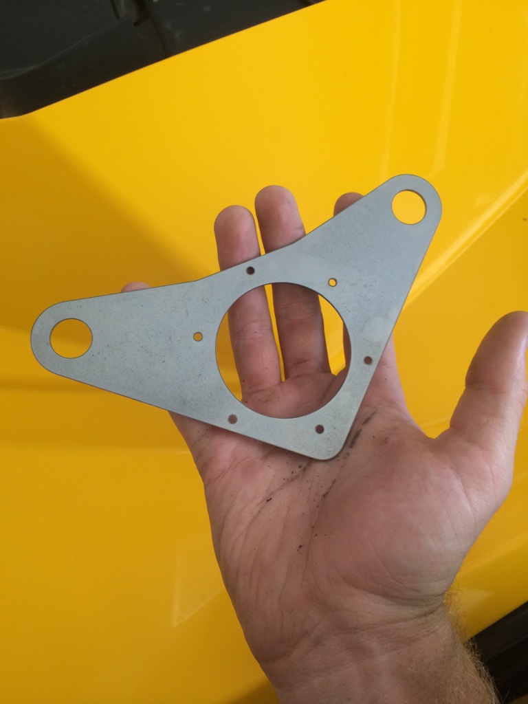

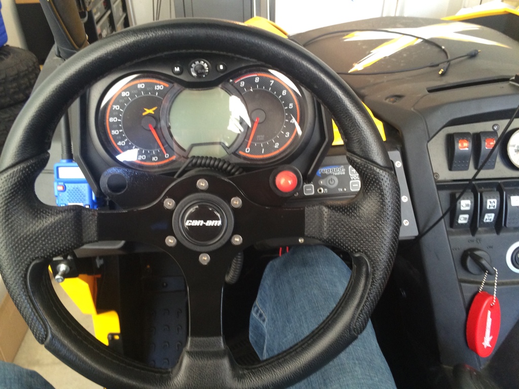

Another update, got my steering wheel mount made and installed.

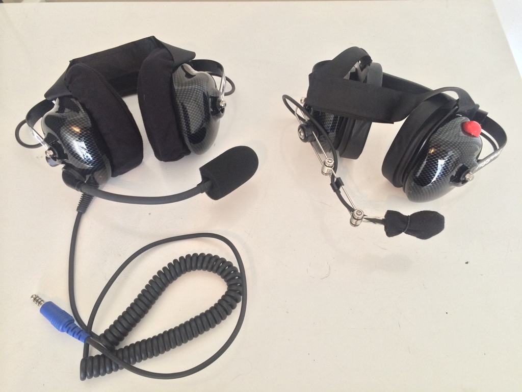

I also ordered a new headset, got the h42 ultimate headset. My original one was the standard h42. The differences between the two is the ultimate has their comfort kit on it which has gel pads, cloth cover, and a foam mic cover. It is also hard wired with a coil cord and their off road plugs, also have a different mic boom.
Headed to the dunes on the 22nd for my bachelor party, will give you guys a little review of everything when I get back.
Well i had an awesome bachelor party and got to use my rugged setup a lot over the weekend. My thoughts on my setup are that it rocks! The 686 intercom is killer, It has plenty of volume and vox adjustments, is really clear even without the DSP Chip (might upgrade to that in the future) even on the beach going around 65mph with the high wind it hardly affected it at all. I ran my Iphone plugged into the back auxiliary port so i could listen to music and also talk over the phone. Phone calls come over the headsets clear and you can definitely blast your music as loud as you want. I have the regular h42 headsets and a h42 ultimate headset. Both are awesome but it is really nice having the longer coil cord on the ultimate, so i will be getting a coil cord with the off road plug and the correct adapter needed to run it. Now for the Rh-5r handheld radio, it worked really well, never had a problem talking to other cars or getting out of range on the rides we went on. in the oregon dunes you really never get to far apart. We used them in the pickups when we were traveling there and back as well, so they are very handy to have. I will be adding an external antenna on my maverick and also adding the battery eliminator kit so i don't have to worry about the battery dying. Even though the battery life on the radio is very good. I also added my ppt button on the steering wheel, i highly recommend to everyone. It makes it way easier to go car to car while driving hard. Overall i am very pleased with my setup and have a bit more fine tuning and a few more little cables and accessories to get and it will be dialed in. Once you drive with and Intercom and car to car communications you will never go back. Makes it way more fun to talk shit to your buddies while riding and also makes it more safe to warn them of things coming up. Thank you Rugged Radios for the awesome product and all the help getting me setup.
