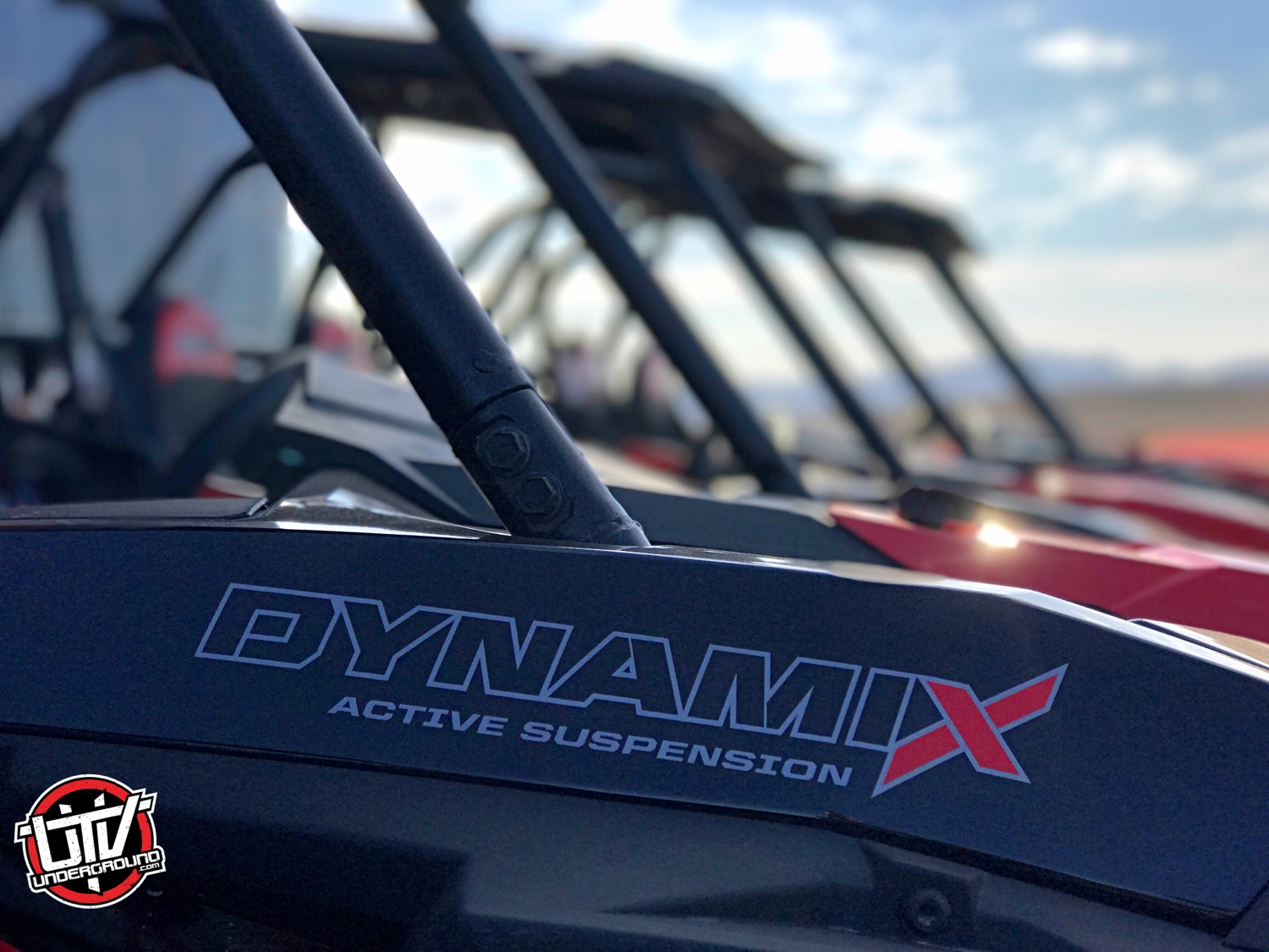

How many racers are going to run the electronic suspension in the new RZR?
crazywatson
#13 - UTVUnderground Approved
Is the new electronic valving give anyone and advantage on the race coarse? Is there any improvements made on the new RZR that will give an advantage on the race coarse besides the electronic valving?

After spending a few hours in this new machine I can tell you it's impressive. I don't think it's right for a race application but it will make an incredible prerunner.
That's a solid guess. I took the Dynamix out for some Rally road testing last night. It's really fun to select modes and let the suspension do it's thing.
