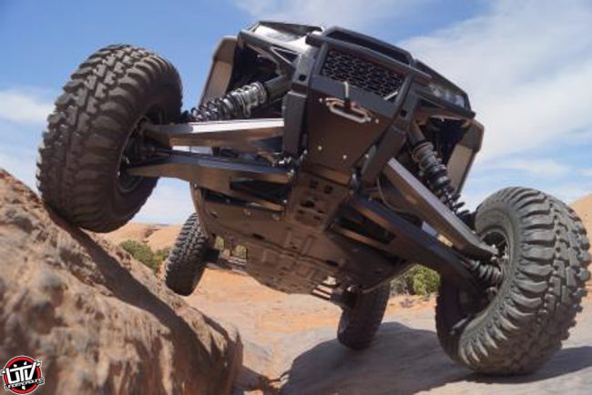

HCR Racing proudly introduced the best, most complete, bolt on suspension upgrade on the market for the true offroad enthusiast. The goal: to exceed all expectations in quality, design, and performance. HCRs proprietary billet, slot & tab design and honeycomb boxed arms are built to withstand the beatings of rigorous off-roading while achieving the optimal combination of strength and appeal. HCRs manufacturing alloy is 30% stronger than 4130 Chromoly and hand TIG welded for strength and aesthetics. 4130 heat treated billet ends are used; allowing all plating to be attached eliminating a potential weak point. This HCR XP1000 kit comes with a custom set of shocks; tested and proven by the owner of King himself. This shock package is a complete custom setup built as a true off road shock from the King Pure Race Series Line. These shocks are both longer in stroke and eye to eye with custom valving and spring rate. These shocks, along with the HCR shock tower, relocate mounting points closer to the ball joint rather than the middle of the arm obtaining a closer to 1:1 motion ratio, and reducing shock fatigue. Finned IBPs are included on rear shocks. This needle valve technology delivers a smooth comfortable ride while still providing substantial dampening force at full compression preventing bottoming out during hard use. Proper springs are provided to still allow full articulation of all 21 of travel in both high and low speed situations. This allows for better valving and lighter spring rates. The track width has been increased by 4 inches on either side, with a 3 inch longer wheelbase for added travel and stability. 1.25 inches additional clearance has also been added to all arms for added ground clearance. RCV extended axle bars are included. These 4340 Chromoly axles boast twice the strength of a stock axle and produce the highest torque test numbers of any aftermarket UTV axle. All components are proudy manufactured in the USA

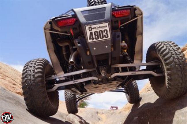

DESIGN
HCR’s proprietary billet, slot and tab design and honeycomb boxed arms are built to withstand the beatings of rigorous off-road riding which achieving the optimal combination of strength and appeal. The custom HCR alloy used to build every kit is 30% stronger than 4130 Cromoly in both heat treated and yield strength. Every external weld is an internal plate structured into the design. while more cost effective to run tube ends for ball joints , all HCR kits run a 4130 heat treated billet end allowing all internal and external plating to be attached to this billet eliminating a potential weak point. Billets are available in both balljoint and spherical applications.

SHOCK TOWER
A shock tower is included with every HCR XP1000 Long Travel Kit. This reduces the amount of compound leverage to achieve a closer to 1:1 motion ration for less shock fatigue. This allows for better valving and lighter spring rates. Chromoly CNC’d suspension mounting points and a bolt on shock tower increase the strength and integrity of the stock chassis.
ADDED WHEELBASE

LINK PACKAGE
depending on what riding style, the correct link can make all the difference…
HIGH LINKS
high links are recommended for the recreational trail rider or Rock crawler. These proprietary boxed high links are built out of the same Custom Alloy as all HCR kits. Internal structuring is added for increased strength and fully hand-tig welded for strength and aesthetics. All needed hardware is included using delrin bushings and crush sleeves.
STRAIGHT LINK
radius rods are recommended for the dual sport rider or pure duner. The straight link is optimal for bottoming and side load impact as it lacks any natural bends. Built out of light but strong .090 wall chromoly tubing , CNC’d bungs and FK bearing heims
RACE LINKS
These heavy duty HCR Race links follow the same design as the standard radius rod with material increased to .120 wall tubing. The 5/8-18 heims are availible in Right hand or left hand combinations for adjustable or non – adjustable link preferences.
