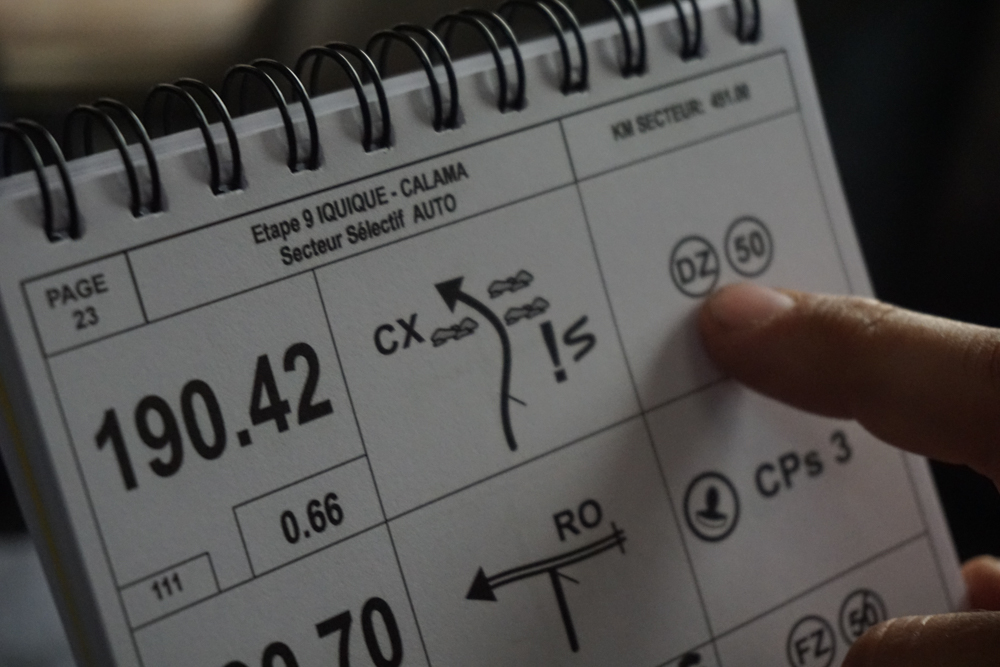

The books are detailed with info that start in the first box on the left of the page. The large number on each note is your race kilometer, the small number below is how far it is from the last note. It is very important to pay special attention to the small number as sometimes these are very quick and if not properly highlighted you may find yourself in a world you don’t want to be in.

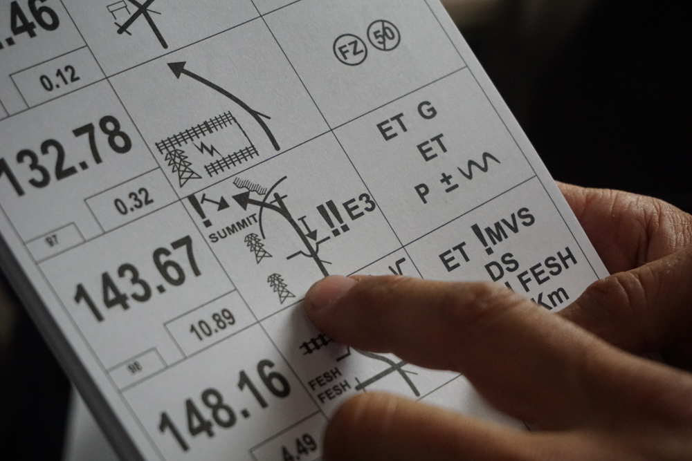

The next box to the right contains a lot of information. If starting from a way point the book will instruct you with a cap heading. The cap heading is ultimately what you have to adhere too as it is easy to stray from that heading if you are following tracks from the car in front of you; you may be following a car that is lost. Other information is described in detail with symbols showing bumps, whether or not they’re visible, summit (blind rise), veer left or right, hard turns, s-turns, rocks, cliffs, powerlines, canyon, cliffs and a myriad of other symbols.
Campbell explains, “So this note is a blind rise or summit into a right hand so I’ll slow him down coming up to that. I don’t need to tell him about the left after because he’s already checked up and if I give him too much it will just confuse him.â€
The notes are pretty straight forward; amongst these are exclamation points which equal danger, much like our down arrows in desert racing; the more exclamations the more the danger. One equals caution, two equals a hazard you much check up for like a square edged wash, three equals something that will end your race. “What I do if there’s something thats going to end our day I highlight the whole section it catches my eye to pay special attention,†said Campbell.
