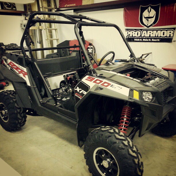

I have been wanting to do this for quite a while. All of the racing I do is by myself (no passenger). Sitting on the side of the car is obviously not optimal for performance reasons. I'm going to fix that for this year's race car.
Goals:
  • Center Seat
  • As close to 1000lb. as I can get
  • Move weight balance forward
  • Larger fuel capacity (~14gal)
  • Retain as many stock cosmetic parts as possible

Starting platform - 2013 Polaris RZR-XP 900 Walker Evans LE
Begin Teardown
Teardown Complete
Hopefully I'll be able to dig into it some more this weekend and get the seat mount tacked up.
First part ordered for the conversion:
SACO 1:1 Steering Box
I went with the 1:1 ratio because this car will be used for WORCS and a couple of other track-style series.
