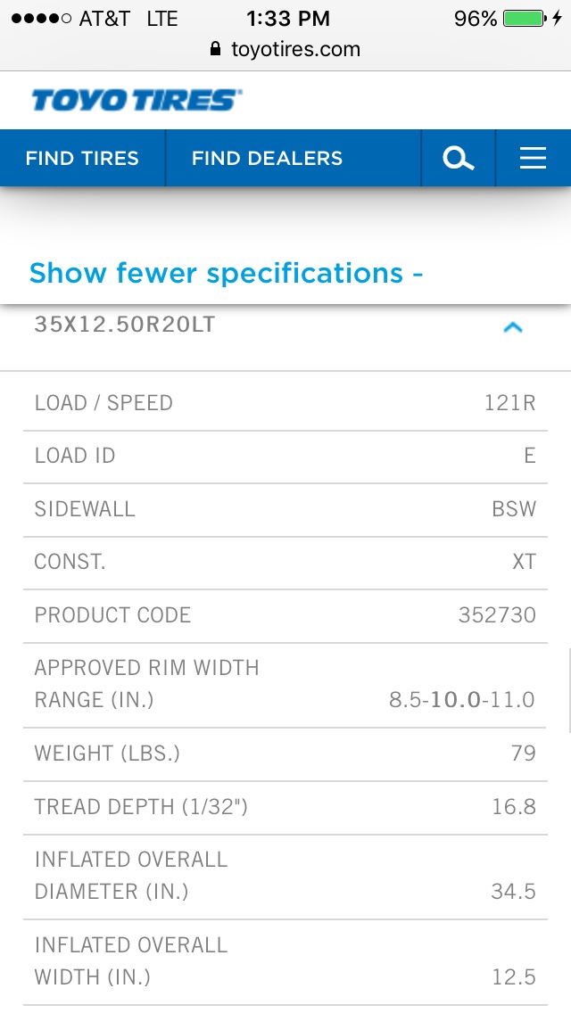

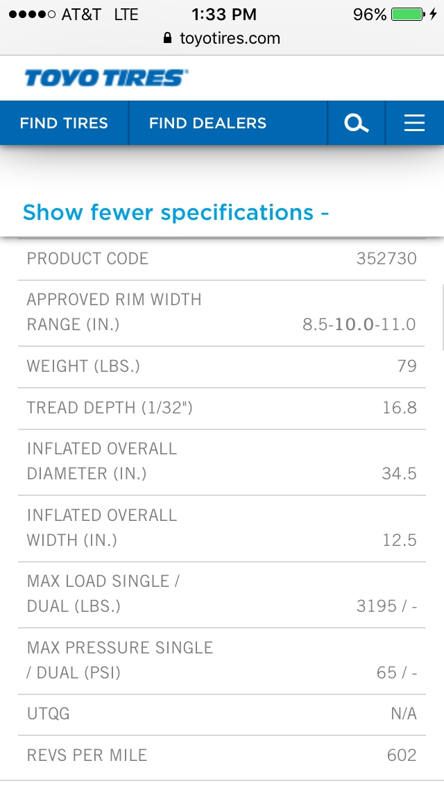

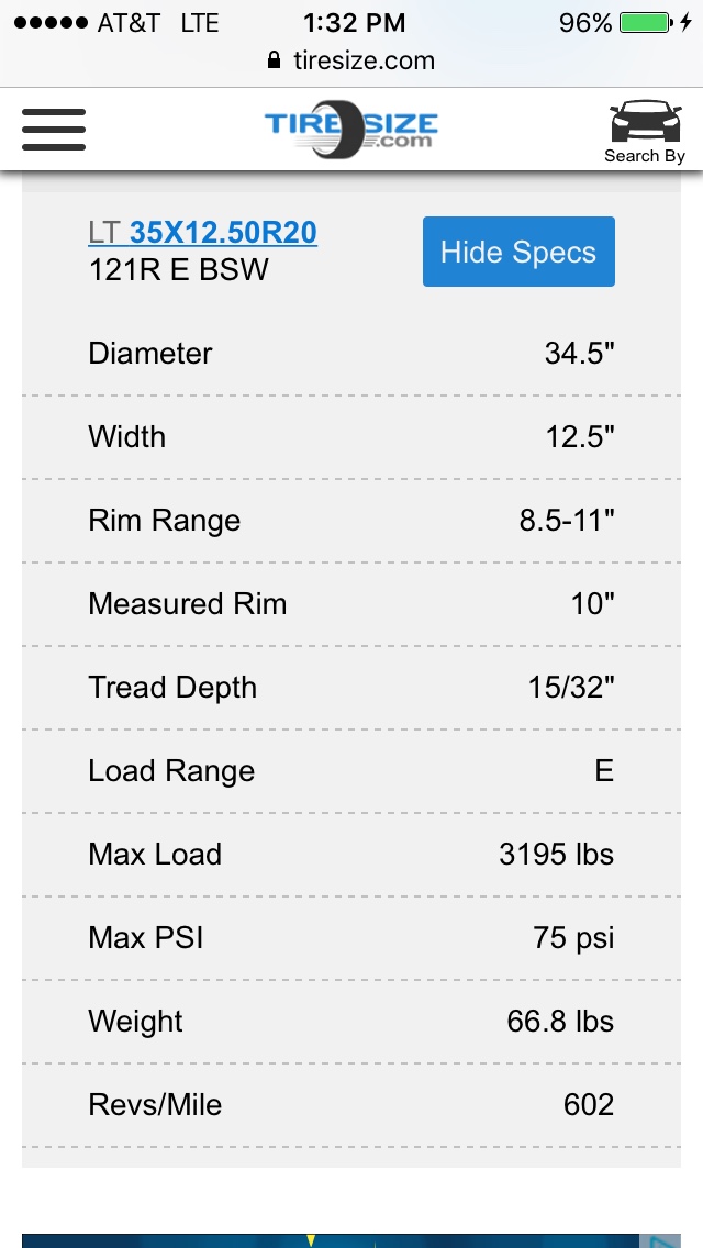

BFG may make a great tire, but their specs are all over the board. They make 35" e rated tire that wont hold 80 psi or the load of other E rated tires. You gonna have to shop around for the size you truly want to run. The specs are all over the board.

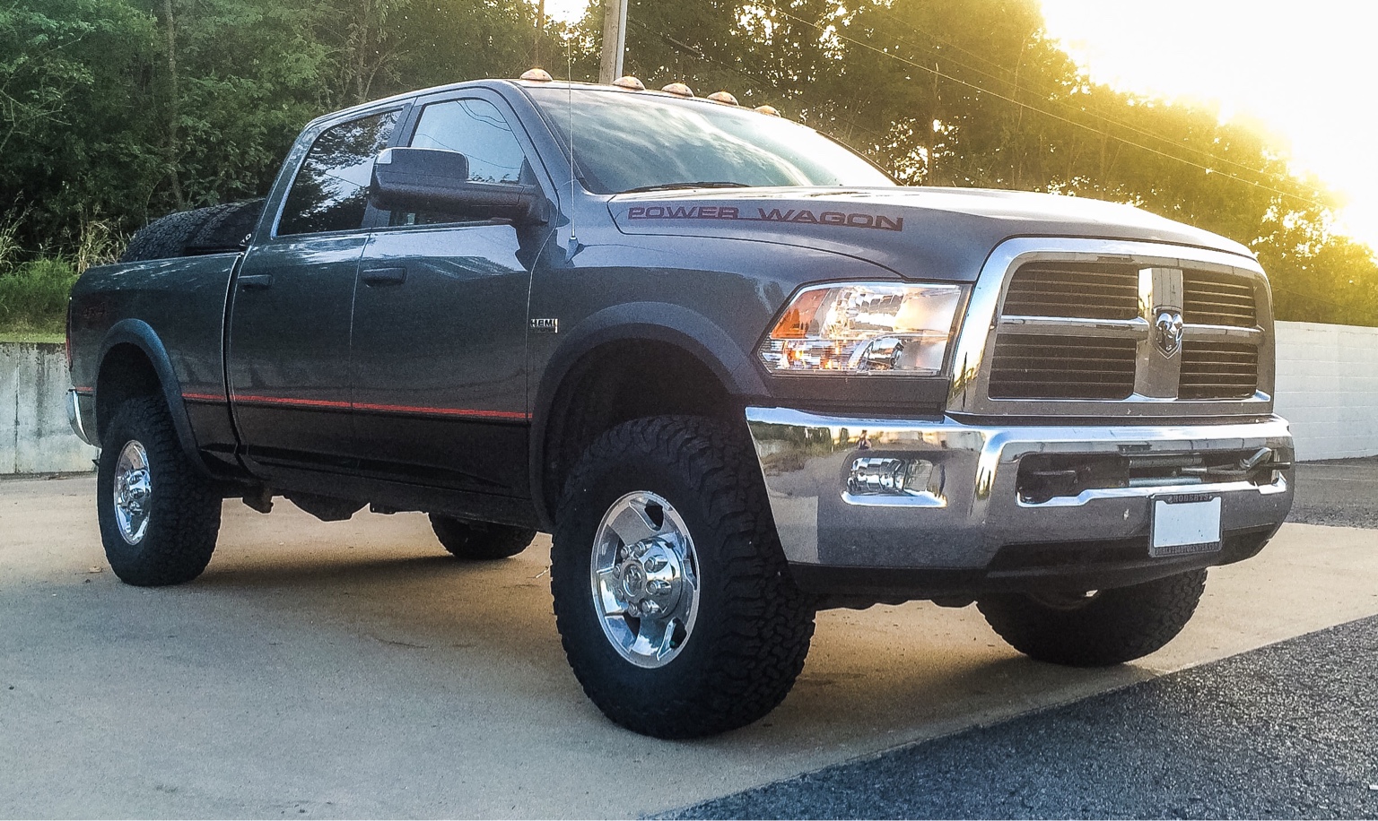

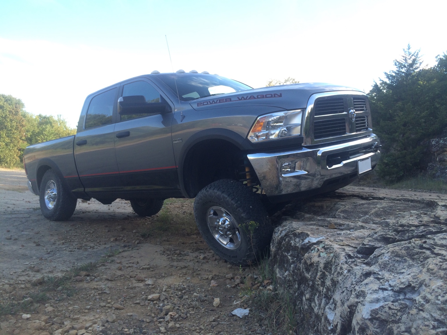

I'm really happy with the 35" BFG KO2's on my Powerwagon and I think they would work great for you. The are silent on the road, track well and have good tread wear. They should work well in dry sandy environments and have a reputation for being very tough. My 2nd choice would be the Toyo Open Country AT II. I think they would perform a little better in mud but they are heavier and will probably have a greater affect on fuel economy. Both tires have a great reputation and I think you would be very pleased either way. As for looks, I like the sidewall on the BFG's better but the Toyos tread looks more aggressive.

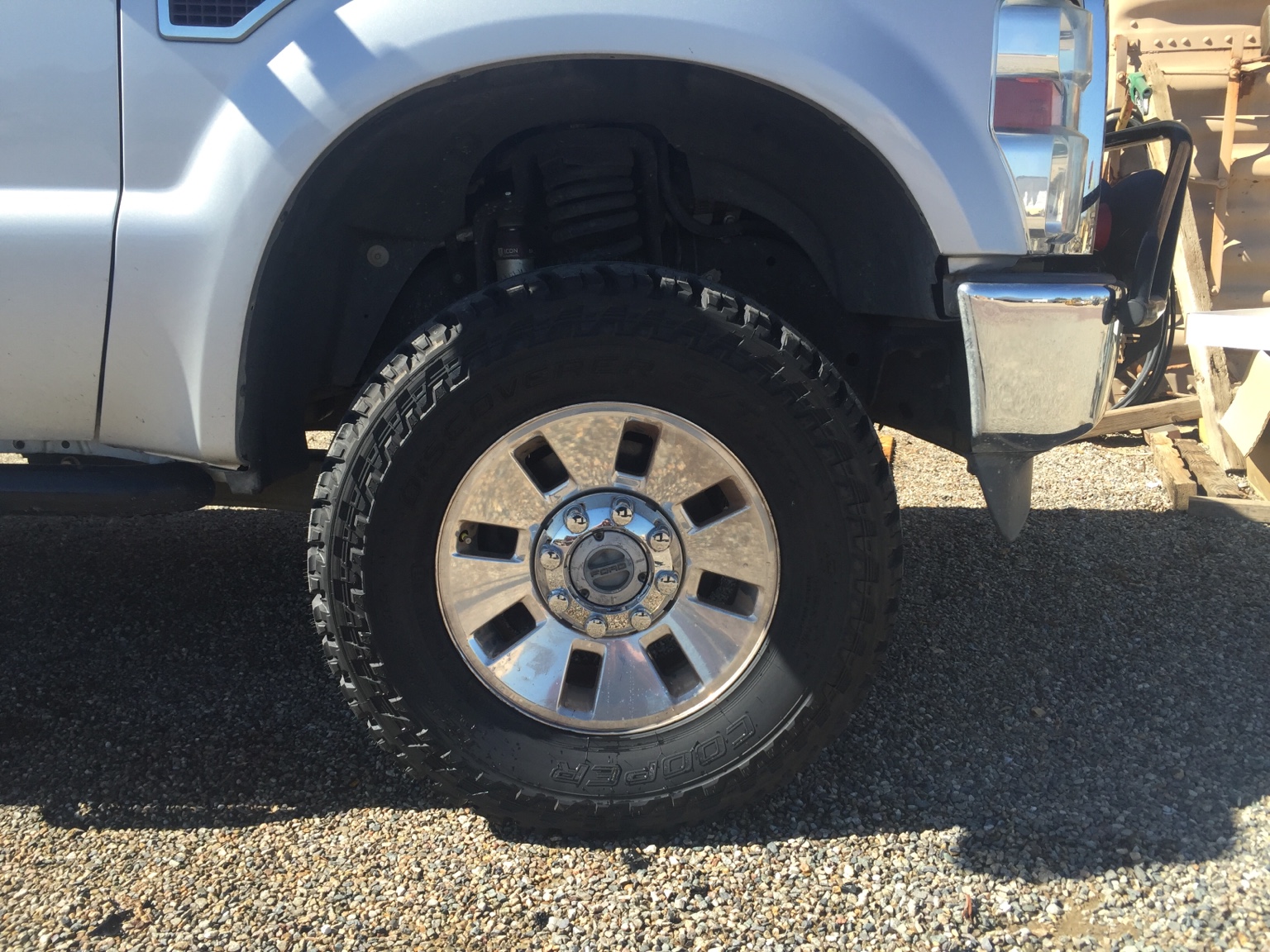

I really wanted to run the new KO2 when they came out but I wasn't happy with the sizes and load rating options. I ended up going with cooper discover ST MAXX and am pretty happy so far they are quiet and grippy. I got 295-70-18 which is 34.5-12-18. Load rating is 4K at 80. Toyo also makes the same size with similar rating. I almost went toyo at2 in the same size since they have a mileage rating and good reviews.

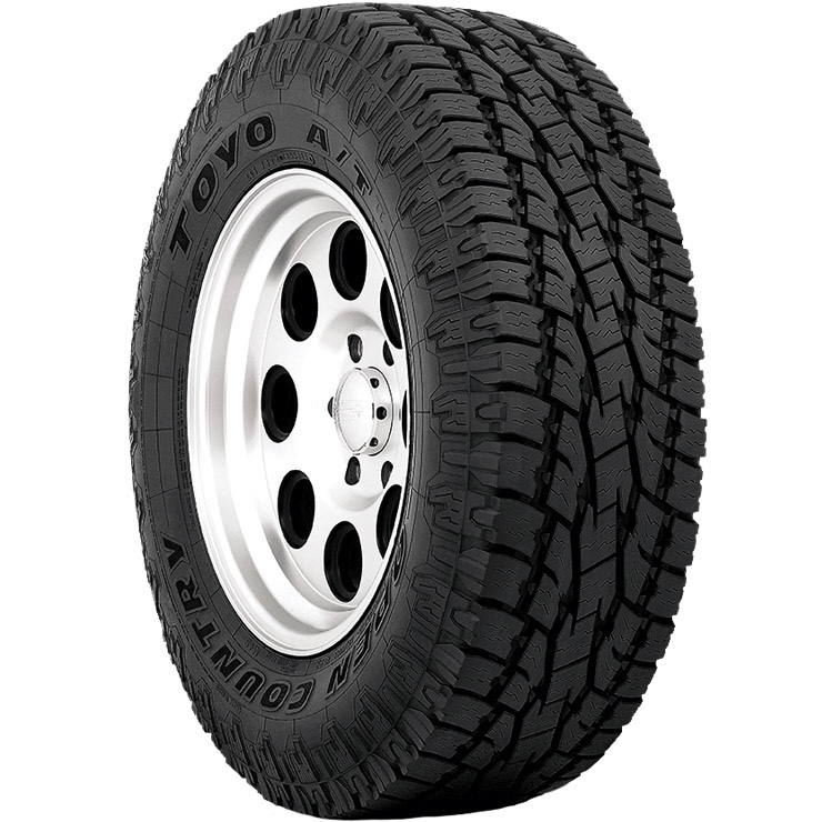

I run the Toyo Open Country AT 285/70-17 on my Chevy. First set got just over 50K, second set I'm right about 55K and hitting the tread bars. They have worn nice & even and have been by far the most quite tire I have run. I won't think about another tire. I plan on getting new ones after the holidays.

I've run Toyo AT II and Toyo MT and loved them both as well.

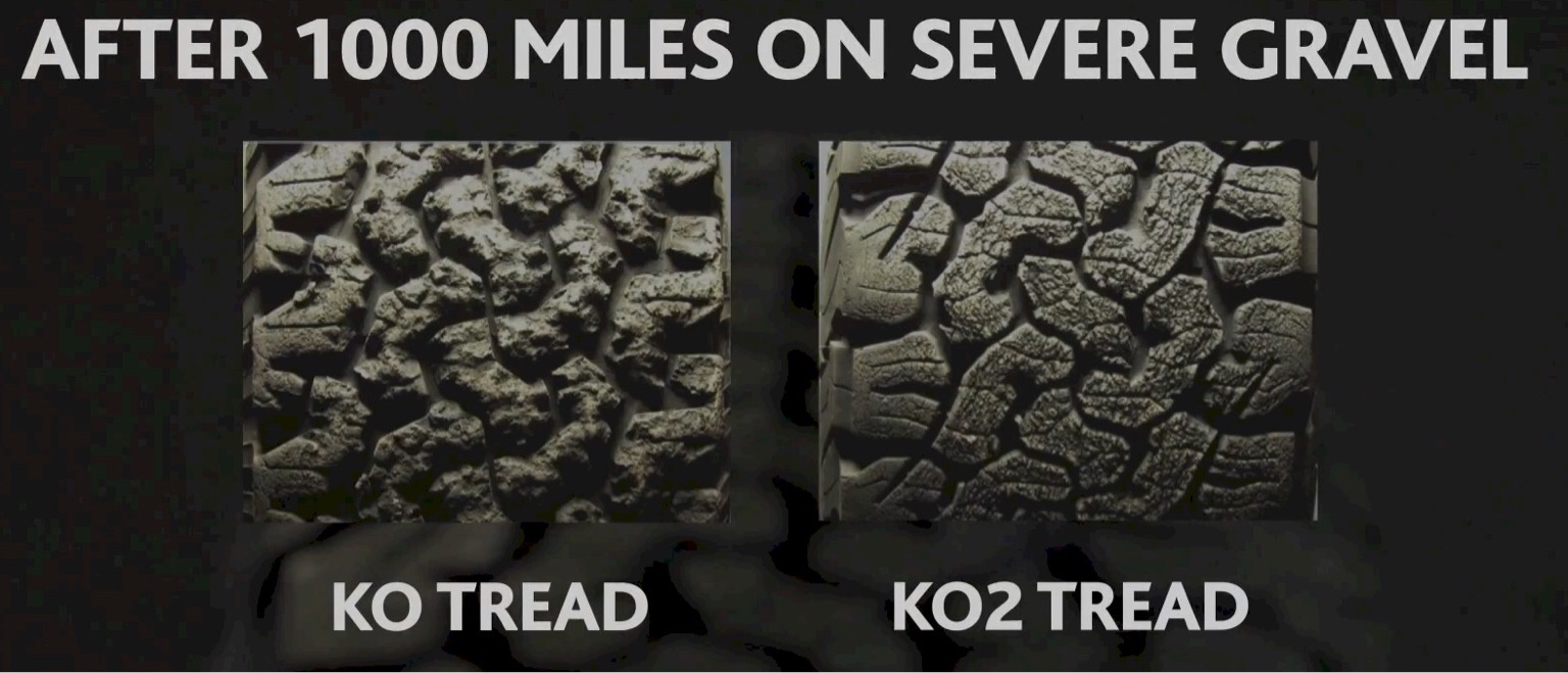

I know the original KO's had problems and personally I would not own another set but the KO2's are a completely different tire. They are better than the original KO's in every way and are now one of the best AT tires made. Warlock may have a point with BFG as a whole going down hill but they got the KO2 right. I have ran them in 275/70R18, 285/70R17 and now 315/70r17 and performance has been exceptional. I am not accusing anyone here of making this mistake but I spent weeks researching tires on every truck and jeep forum, Rzr forum and expedition portal. I found lots people telling horror stories about the KO2's and later in the thread it was discovered that they were in fact talking about the original KO's not realizing there was a difference. In all my research I found very few, if any, negative reviews of the KO2's.
I didn't say all that to sell anyone on the BFG, I'm a huge fan of the toyo AT2's and they are easily my 2nd choice. If I was shopping mud tires I'd recommend the Toyo Mt's, passenger car tires would be the general altimax, highway tires would likely be a Michelin and performance tires would be either Michelin or pirelli depending on application. I am far from brand loyal, but I hate seeing misinformation.
The tread design is similar but the tread compound and overall construction is completely different. This is a pretty good example of the improvement.

Just mounted up my 3rd set of the Toyo Open Country AT's. This is my first set of the AT2's. My last set had 53K at the wear bar. (Thought I was closer to 55K) I would have got 55K but all this rain made me get tires sooner.
285/70-17 10 ply E load rating
