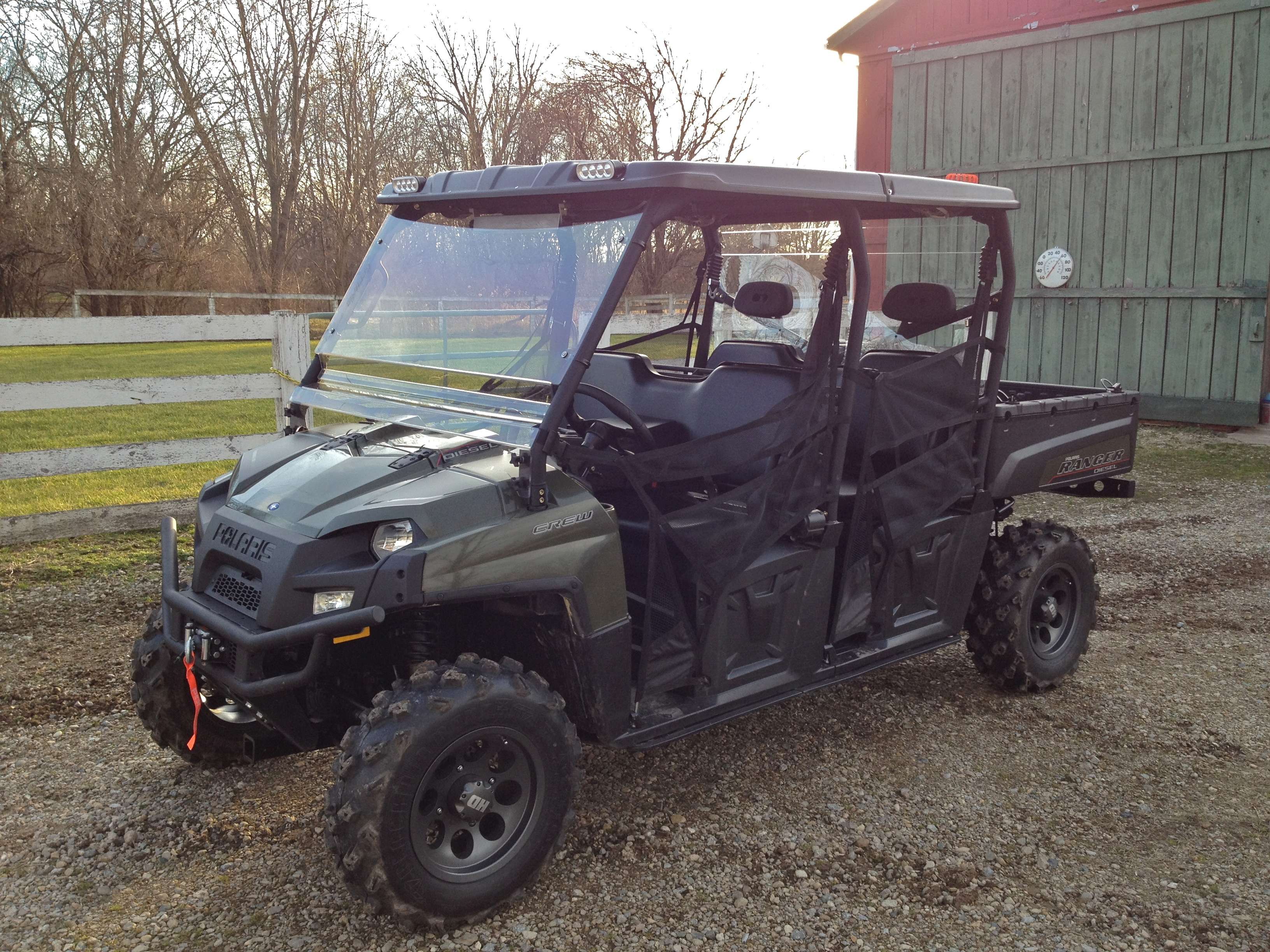

Got it for $10,600 on eBay. It's great for the family. I've added lights, winch, and windshield. Wheels and tires are coming next week.

I cranked up the suspension and added 14" HD1 wheels and 27" STI Black Diamond tires. I like it a lot, so far. The Black diamonds run a little skinny though. They are at least an inch narrower than the stock tires, but that makes em easier to steer, and they should do good in the snow. I have 9" in the front and 11" wide in the rear. I think I could easily fit 11" up front and 14" wide in the rear. But its all good. I like the ITP HD1 wheels. They have a real thick rim lip. I think the offset is a little more too.

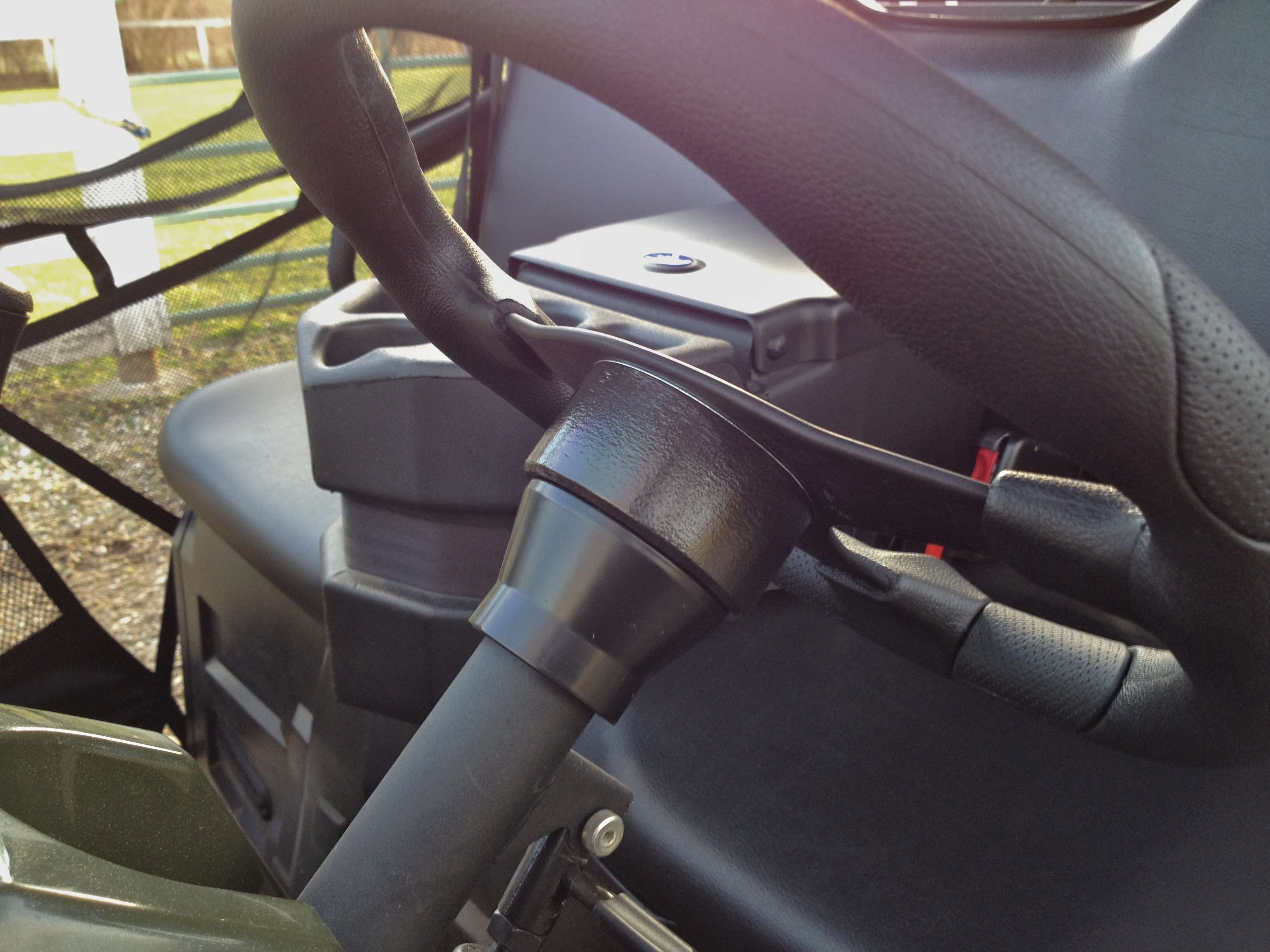

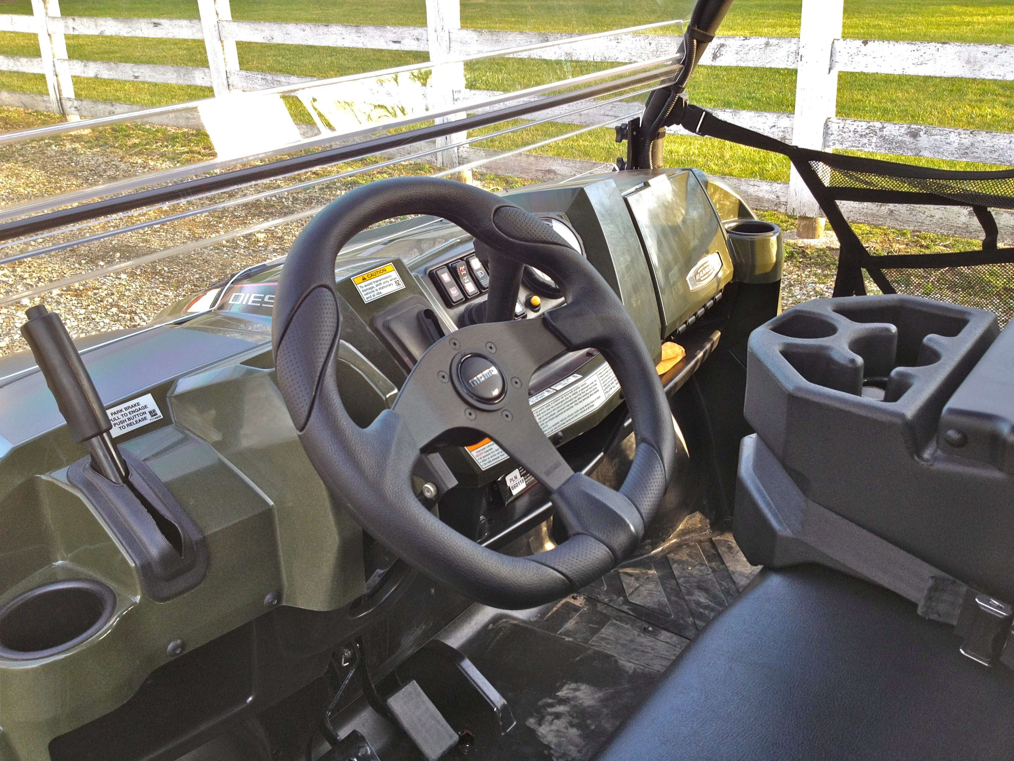

I added a MOMO- Quark- Black steering wheel and I really like it. I got it from sidebysidesports. It came with a Grant tapered steering wheel adapter which adapts the splines to a 3 hole pattern, then the steering wheel came with a MOMO 3 hole to 6 hole adapter which bolts to the steering wheel. The steering wheel is about 1" narrower diameter than the stock one, which makes it easier to get in and out of the vehicle. And I'm not sure how its possible, but its easier to steer the tires now. A smaller steering wheel should actually be more difficult to steer because theres less leverage. Maybe we loosened up something in the steering when we knocked off the stock steering wheel. Whatever we did, its easier to steer now. To remove the stock steering wheel from the splines: Pull of center cap, loosen big nut in the middle. Hold on the steering wheel while you hit the steel spline shaft down with a hammer. This should make the steering wheel pop loose from the splines and be able to pull wheel off.
